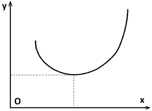

The following
graph shows the variation of injection pressure (y-axis) with
respect to filling time (x-axis). The optimal filling time is
located at the bottom of the curve. For short or very long
filling times, higher injection pressure values are required.
