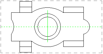

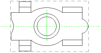

In some situations, not all
entities that overlap a dimension bounding box must be included. Use the
RemoveFromDimBoundingBox command to exclude entities from
dimension bounding boxes, without deleting them from the drawing. Dimension bounding
boxes update automatically based on the remaining set of entities.
