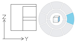

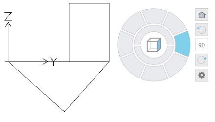

  • The Inner Ring lets you set top and bottom views.

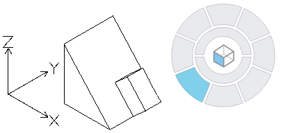

  • The Outer Ring provides a set of eight sectors for quickly switch between standard and isometric views of your model. Each sector of the Outer Ring corresponds to a view. When you click on a sector, the software moves the scene to the corresponding view.

Changing the View Orientation According to the Active CCS
Using the View Navigator, you can change the view orientation within the active CCS or WCS.
To change the view orientation according to the CCS:
  1. In the graphics area, set up a suitable CCS.
  2. Hover over the View Navigator, click and select View Navigator Properties from the menu.
  3. In the View Navigator Properties dialog box, select Use active CCS.
Example:
WCS
CCS
 To control CCSs, use the CCS and CSStyle commands.
