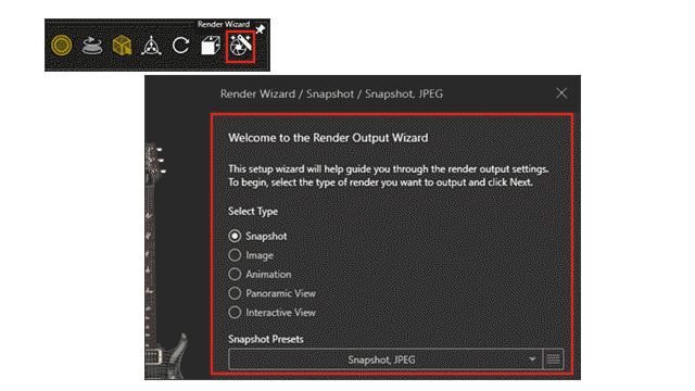

To create renderings:
  1. In the main toolbar, click Render Wizard .
  2. In the Welcome page, select the Render Type and do the following:
    1. From the list, select a render preset or create a custom preset using the Smart Control Bar.
    2. In the pages of the wizard, specify the parameters for the render type you have selected.
    3. Do one of the following:
      • Click Render to begin the rendering process.
      • (SOLIDWORKS Visualize Professional Only) Select Queue in the rendering options to add the current rendering to the SOLIDWORKS Visualize Queue so you can render it later.
      The finished render is saved in the Images library at SOLIDWORKS Visualize Content\Images.
