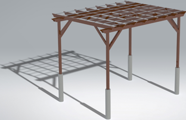

You can create the scene lighting based on the sunlight.
With a sunlight environment, you can stage a model under a realistic
sky and light from the sun at a specific time of year and location on earth.
There are two ways to create a sunlight environment. You can create a
sunlight environment in SOLIDWORKS Visualize or you can create a sunlight
environment in SOLIDWORKS and import the sunlight data to SOLIDWORKS Visualize.
To light the scene based on the sunlight:
