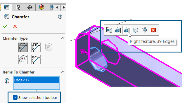

A selection
accelerator toolbar is available for chamfers so you can quickly select edges to
chamfer.
Benefits: You spend
less time on details and have more time for design.
To use the selection accelerator toolbar:
- In the Chamfer PropertyManager, click Show
selection toolbar to activate the toolbar.
- For Items to Chamfer, select an edge to display the
selection toolbar in the graphics area.
- Hover over the available selections on the toolbar to display the selected edges
on the model in the graphics area. To select those edges, click the item on the
toolbar.
