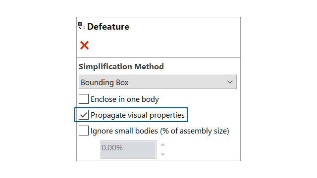

To propagate visual properties in defeature groups:
  1. Open a model, and click Defeature (Tools toolbar) or Tools > Defeature.
  2. In the PropertyManager, select Silhouette .
  3. Click Next until the Defeature - Define Groups page appears.
  4. Under Simplification Method, select Propagate visual properties.
