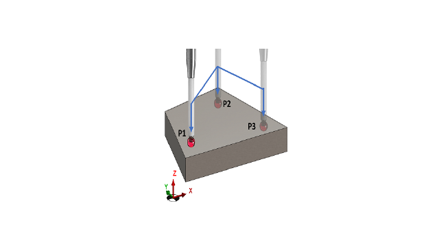

With the 3 Point Plane probe
cycle,
SOLIDWORKS
CAM measures the selected surface using three points on that surface.
The probed points establish a plane.
When you select 3 Point Plane,
SOLIDWORKS
CAM positions the three points at default offset values. You can
modify the offset values and probe the points
at
the required locations.
