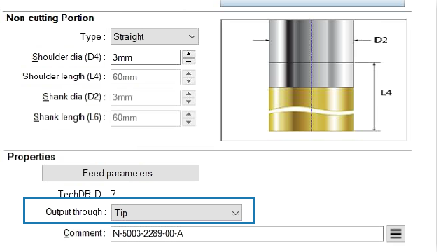

You
can specify the Output through parameter for probe
tools. This parameter generates the toolpath and G-code with the set tool reference
point.
In the
Operation Parameters dialog box, on the
Tool tab, on the
Probe Tool tab, under
Properties, you can specify options for
Output
through:
- Tip. Generates the toolpath with reference to the tip of
the probe tool.
- Center. Generates the toolpath with reference to the
center of the probe tool.
