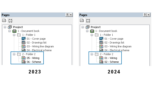

Drawing Mark Numbers (2024 SP2)
You can number drawings by folder.This lets you assign the same drawing number across multiple folders. Previously drawing marks were unique per book.
In the Electrical Project Configuration dialog box, under Marks unique by, for Drawing, specify Electrical Project, Folder, or Book.
