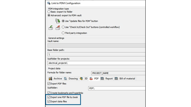

Exporting Data Files (2024 SP2) In Link to PDM Configuration dialog box, you can include the data files in the exported PDF file. To export data files, click Link to PDM Configuration > PDF and select Export data files. The option One file per book is renamed as Export one PDF file by book. Parent topicSOLIDWORKS Electrical Annotate Tab (2024 SP3) Terminal Strip Drawings (2024 SP3) 6W Tags Enhancements in ECP(2024 FD03) Drawing Mark Numbers (2024 SP2) Import Options to Manage Cable References and Manufacturer Parts (2024 SP2) Restructuring the Electrical Component Tree SOLIDWORKS Electrical Tutorials (2024 FD01) Cable Management (2024 SP1) Dynamic Link Between Drawings (2024 SP1) Sharing Links in the Electrical Content Portal (2024 SP1) Single Entry for Cables or Wires in BOM Tables (2024 SP1) Zoom to Fit When Opening Drawings (2024 SP1) Aligning Components Changing the Length of Multiple Rails and Ducts Filtering Auxiliary and Accessory Parts Auto Balloons in 2D Cabinets Removing Manufacturer Part Data Resetting an Undefined Macro Variable Shortening Lists Using Ranges SOLIDWORKS Electrical Schematic Enhancements SOLIDWORKS Electrical Performance Improvement
