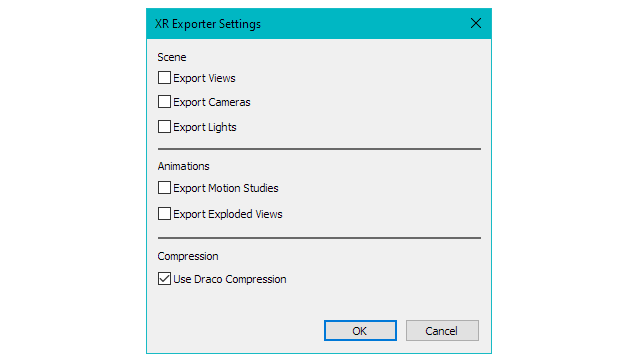

You
can export SOLIDWORKS CAD files to .glb or .gltf file formats.
The files contain
information such as geometry, appearances, textures, animations, motion studies,
configurations, display states, exploded views, lights, and metadata. For large files,
the export supports
Draco,
the standard file compression mechanism for .glb and
.gltf files.
