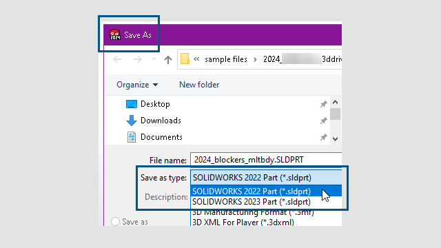

| Lists items that you
must manually address before you can save the file as a
previous version of SOLIDWORKS. If you remove or edit
the incompatible items, it might change the mass
properties, size, shape, or rebuild behavior of the
model. In some instances, you
must delete the incompatible item. In other
instances, changing a feature option might address
The
list of incompatible items is in the order that they
first appear in the FeatureManager design
tree.
