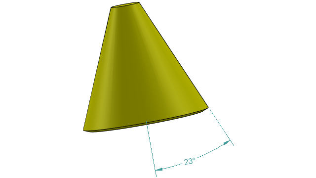

You can display a
conical angle dimension as a half
angle.
This lets you convert a full angle of a cone to a half
angle.
To
display
half
angles
of conical
dimensions:
- In the DimXpert Value PropertyManager,
under Primary Value, select Show as half angle.
