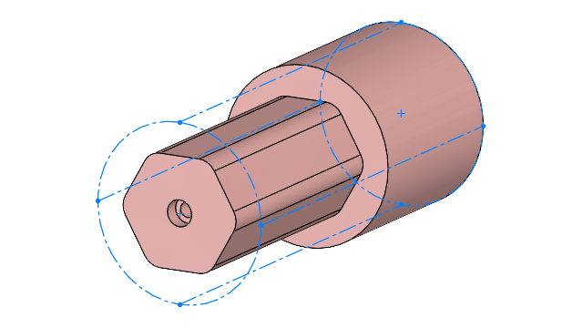

You can create cylindrical bounding boxes that are useful for
bodies with cylindrical geometry such as rotational, circular, or turned parts. SOLIDWORKS® captures the bounding box parameters
and records them in the Custom Properties dialog
box.
Click . In the PropertyManager, under Type of
Bounding Box, select Cylindrical.
SOLIDWORKS generates the smallest cylindrical bounding box that fits the model.
