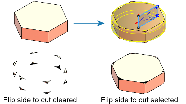

You
can flip the side to cut for cut-revolve features, similar to cut-extrude features. This
retains the inner portion of a sketch and discards the region outside the
sketch.
In the Cut-Revolve PropertyManager, under Direction 1, select Flip side
to cut. In earlier releases, this option did not exist and required
extra steps to achieve the required results.
