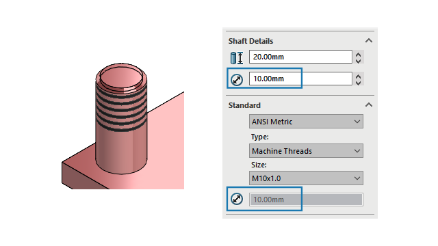

You can apply a Stud Wizard
feature to a shaft that has the same diameter as the thread. You can modify the size of
Stud Wizard features created in previous
versions of
SOLIDWORKS
so the thread diameter matches the shaft diameter.
The software supports
this functionality for studs created on a cylindrical body or surface. In earlier
releases, the thread diameter had to be smaller than the shaft
diameter.
