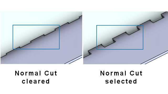

When
you use the Tab and Slot tool, you can specify that the slot is
normal to the sheet even if the tab is at an angle to the slot. Slots that are normal to
are essential in the manufacturing process.
In the Tab
and Slot PropertyManager, under Slot, select
Normal Cut.
