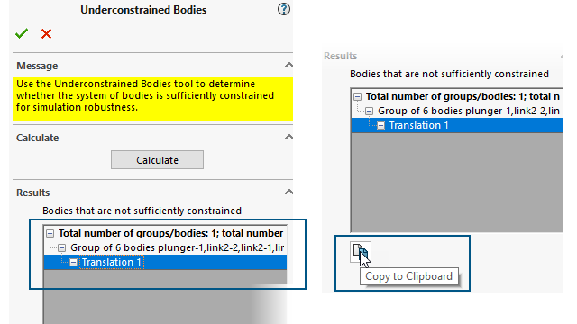

There are several usability enhancements for the Underconstrained Bodies PropertyManager.
- You can copy the results of the underconstrained bodies detection tool to
the clipboard.
- The list that shows the bodies that are not sufficiently
constrained in the Results section is
expandable for improved readability.
- It takes less time to show the animations of underconstrained bodies.
The
graphics quality of the animations that highlight underconstrained bodies is
improved.
