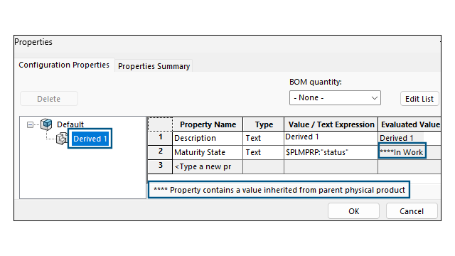

The software links the PLM attributes of custom properties of representations to the parent physical products.
The software adds **** as a prefix to Evaluated Value and displays a footnote if the:
  • Configuration is a representation
  • Custom property has at least one PLM attribute that it inherits from the parent physical product
Previously, for a PLM property, the software did not display a value for a representation of a parent physical product.
Click Tools > Options > 3DEXPERIENCE Integration and select Update SOLIDWORKS files for compatibility with the 3DEXPERIENCE platform.
In the Properties dialog box, when you select a representation, the evaluated value appears for the PLM property that you select.
