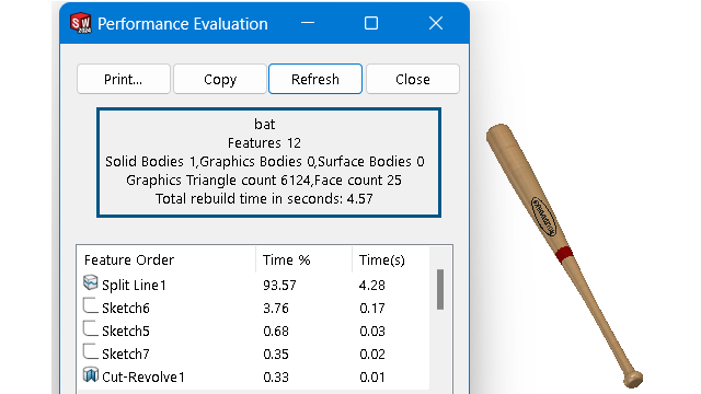

For parts, the
Performance Evaluation dialog box displays the total number of
graphics triangles and faces of all bodies combined plus other useful
information.
The dialog box also displays the number of
solid, graphics, and surface bodies, and the total rebuild time in seconds. To access
this information, with a part open, click Performance
Evaluation
(Evaluate toolbar) or .
This information helps you determine the complexity of
the model's geometry and the potential impact on performance.
