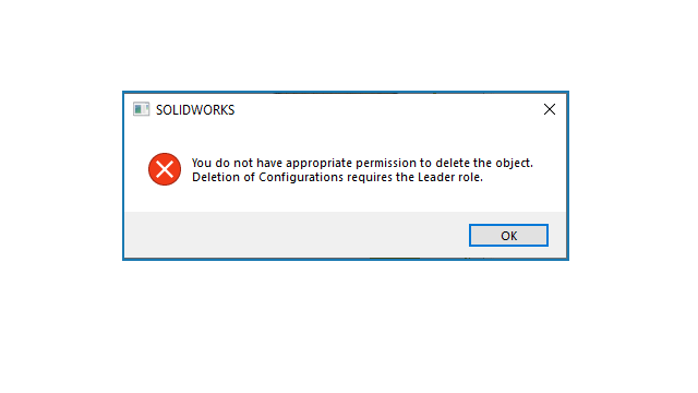

Deleting Virtual Components (2024 FD03)
You can now delete a virtual part or a virtual assembly even if you are an Author.
Benefits: Deleting the virtual components in not dependent on the roles.
Now even if you delete the virtual components the save process does not get blocked. However the save process is blocked if you delete a configuration. To delete a configuration you must have the Leader role.
