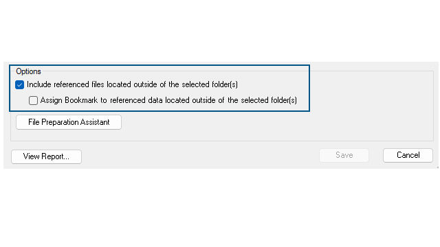

Managing Bookmark Reference in Batch Save (2024 FD02)
An option Assign Bookmark to referenced data located outside selected folder is added to the Batch Save to 3DEXPERIENCE dialog box.
Benefits: You get the flexibility to attach the referenced files to the bookmarks.
While saving with Batch Save to 3DEXPERIENCE, if in a folder there are files with references in other folder, and the Include referenced files located outside the selected folder and Assign Bookmark to referenced data located outside selected folder options are selected, the references get added to the selected bookmark.
