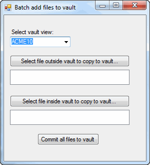

' Postconditions:
'  1. The Batch add files to vault dialog box displays.
'     a. Select a vault view.
'     b. Click Select file outside vault to copy to vault.
'     c. In the Select File dialog:
'        1. Click a file outside the vault.
'        2. Click Open.
'     d. Click Select file inside vault to copy to vault.
'     e. In the Select File dialog:
'        1. Click a file in the vault.
'        2. Click Open.
'     f. Click Commit all files to vault.
'  2. Click Add in the Batch Items dialog box.
'  3. Click OK to close the message box.
'     Two new folders, Folder1 and Folder2, are created in the vault's
'     root directory. The first selected file is copied to Folder1.
'     The second selected file is copied to Folder2.
'  4. Close the Batch add files to vault dialog box.

'Form1.Designer.vb
<Global.Microsoft.VisualBasic.CompilerServices.DesignerGenerated()> _
Partial Class Form1
    Inherits System.Windows.Forms.Form
    'Form overrides dispose to clean up the component list.
    <System.Diagnostics.DebuggerNonUserCode()> _
    Protected Overrides Sub Dispose(ByVal disposing As Boolean)
        Try
            If disposing AndAlso components IsNot Nothing Then
                components.Dispose()
            End If
        Finally
            MyBase.Dispose(disposing)
        End Try
    End Sub
    'Required by the Windows Form Designer
    Private components As System.ComponentModel.IContainer
    'NOTE: The following procedure is required by the Windows Form Designer
    'It can be modified using the Windows Form Designer.
    'Do not modify it using the code editor.
    <System.Diagnostics.DebuggerStepThrough()> _
    Private Sub InitializeComponent()
        Me.VaultsLabel = New System.Windows.Forms.Label()
        Me.VaultsComboBox = New System.Windows.Forms.ComboBox()
        Me.BatchAdd = New System.Windows.Forms.Button()
        Me.CopyToVault = New System.Windows.Forms.Button()
        Me.FileList1 = New System.Windows.Forms.ListBox()
        Me.CopyFromVault = New System.Windows.Forms.Button()
        Me.FileList2 = New System.Windows.Forms.ListBox()
        Me.SelectFileDialog = New System.Windows.Forms.OpenFileDialog()
        Me.SuspendLayout()
        'VaultsLabel
        Me.VaultsLabel.AutoSize = True
        Me.VaultsLabel.Location = New System.Drawing.Point(12, 27)
        Me.VaultsLabel.Name = "VaultsLabel"
        Me.VaultsLabel.Size = New System.Drawing.Size(91, 13)
        Me.VaultsLabel.TabIndex = 0
        Me.VaultsLabel.Text = "Select vault view:"
        'VaultsComboBox
        Me.VaultsComboBox.FormattingEnabled = True
        Me.VaultsComboBox.Location = New System.Drawing.Point(12, 43)
        Me.VaultsComboBox.Name = "VaultsComboBox"
        Me.VaultsComboBox.Size = New System.Drawing.Size(121, 21)
        Me.VaultsComboBox.TabIndex = 1
        'BatchAdd
        Me.BatchAdd.Location = New System.Drawing.Point(67, 236)
        Me.BatchAdd.Name = "BatchAdd"
        Me.BatchAdd.Size = New System.Drawing.Size(123, 23)
        Me.BatchAdd.TabIndex = 2
        Me.BatchAdd.Text = "Commit all files to vault"
        Me.BatchAdd.UseVisualStyleBackColor = True
        'CopyToVault
        Me.CopyToVault.Location = New System.Drawing.Point(12, 80)
        Me.CopyToVault.Name = "CopyToVault"
        Me.CopyToVault.Size = New System.Drawing.Size(239, 23)
        Me.CopyToVault.TabIndex = 3
        Me.CopyToVault.Text = "Select file outside vault to copy to vault..."
        Me.CopyToVault.UseVisualStyleBackColor = True
        'FileList1
        Me.FileList1.FormattingEnabled = True
        Me.FileList1.Location = New System.Drawing.Point(12, 109)
        Me.FileList1.Name = "FileList1"
        Me.FileList1.Size = New System.Drawing.Size(239, 30)
        Me.FileList1.TabIndex = 4
        'CopyFromVault
        Me.CopyFromVault.Location = New System.Drawing.Point(12, 160)
        Me.CopyFromVault.Name = "CopyFromVault"
        Me.CopyFromVault.Size = New System.Drawing.Size(239, 23)
        Me.CopyFromVault.TabIndex = 5
        Me.CopyFromVault.Text = "Select file inside vault to copy to vault..."
        Me.CopyFromVault.UseVisualStyleBackColor = True
        'FileList2
        Me.FileList2.FormattingEnabled = True
        Me.FileList2.Location = New System.Drawing.Point(12, 189)
        Me.FileList2.Name = "FileList2"
        Me.FileList2.Size = New System.Drawing.Size(239, 30)
        Me.FileList2.TabIndex = 6
        'SelectFileDialog
        Me.SelectFileDialog.Title = "Select File"
        'Form1
        Me.AutoScaleDimensions = New System.Drawing.SizeF(6.0!, 13.0!)
        Me.AutoScaleMode = System.Windows.Forms.AutoScaleMode.Font
        Me.ClientSize = New System.Drawing.Size(284, 291)
        Me.Controls.Add(Me.FileList2)
        Me.Controls.Add(Me.CopyFromVault)
        Me.Controls.Add(Me.FileList1)
        Me.Controls.Add(Me.CopyToVault)
        Me.Controls.Add(Me.BatchAdd)
        Me.Controls.Add(Me.VaultsComboBox)
        Me.Controls.Add(Me.VaultsLabel)
        Me.Name = "Form1"
        Me.Text = "Batch add files to vault"
        Me.ResumeLayout(False)
        Me.PerformLayout()
    End Sub
    Friend WithEvents VaultsLabel As System.Windows.Forms.Label
    Friend WithEvents VaultsComboBox As System.Windows.Forms.ComboBox
    Friend WithEvents BatchAdd As System.Windows.Forms.Button
    Friend WithEvents CopyToVault As System.Windows.Forms.Button
    Friend WithEvents FileList1 As System.Windows.Forms.ListBox
    Friend WithEvents CopyFromVault As System.Windows.Forms.Button
    Friend WithEvents FileList2 As System.Windows.Forms.ListBox
    Friend WithEvents SelectFileDialog As System.Windows.Forms.OpenFileDialog
End Class
