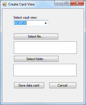

' Postconditions:
' 1. Displays the Create Card View dialog box.
' 2. Select the vault in which you created a folder and
'    checked out a file.
' 3. Click either:
'    a. Select file.
'    b. In the Select File dialog:
'       1. Click the file checked out in Preconditions step 5.
'       2. Click Open.
'       3. Inspect the message box, then click OK.
'    c. In the file data card, modify a field.
'    d. Click Save data card.
'    e. Check in the file and inspect its data card.
'       - or -
'    a. Select folder.
'    b. In the Select Folder dialog, select the vault folder created in
'       Preconditions step 4 and click OK.
'    c. Inspect the message box, then click OK.
'    d. In the folder data card, click the Edit Values tab.
'    e. Modify a field.
'    f. Click Save data card.
'    g. Inspect the folder card in the vault.
' 4. Close the Create Card View dialog box.

        Me.VaultsLabel = New System.Windows.Forms.Label()
        Me.VaultsComboBox = New System.Windows.Forms.ComboBox()
        Me.SelectFile = New System.Windows.Forms.Button()
        Me.File1List = New System.Windows.Forms.ListBox()
        Me.SaveCard = New System.Windows.Forms.Button()
        Me.OpenFileDialog1 = New System.Windows.Forms.OpenFileDialog()
        Me.SelectFolder = New System.Windows.Forms.Button()
        Me.Folder1List = New System.Windows.Forms.ListBox()
        Me.Cancel = New System.Windows.Forms.Button()
        Me.SuspendLayout()
        'VaultsLabel
        Me.VaultsLabel.AutoSize = True
        Me.VaultsLabel.Location = New System.Drawing.Point(36, 24)
        Me.VaultsLabel.Name = "VaultsLabel"
        Me.VaultsLabel.Size = New System.Drawing.Size(91, 13)
        Me.VaultsLabel.TabIndex = 0
        Me.VaultsLabel.Text = "Select vault view:"
        'VaultsComboBox
        Me.VaultsComboBox.FormattingEnabled = True
        Me.VaultsComboBox.Location = New System.Drawing.Point(39, 40)
        Me.VaultsComboBox.Name = "VaultsComboBox"
        Me.VaultsComboBox.Size = New System.Drawing.Size(121, 21)
        Me.VaultsComboBox.TabIndex = 1
        'SelectFile
        Me.SelectFile.Location = New System.Drawing.Point(39, 85)
        Me.SelectFile.Name = "SelectFile"
        Me.SelectFile.Size = New System.Drawing.Size(157, 23)
        Me.SelectFile.TabIndex = 2
        Me.SelectFile.Text = "Select file..."
        Me.SelectFile.UseVisualStyleBackColor = True
        'File1List
        Me.File1List.FormattingEnabled = True
        Me.File1List.HorizontalScrollbar = True
        Me.File1List.Location = New System.Drawing.Point(40, 114)
        Me.File1List.Name = "File1List"
        Me.File1List.SelectionMode = System.Windows.Forms.SelectionMode.MultiExtended
        Me.File1List.Size = New System.Drawing.Size(220, 43)
        Me.File1List.TabIndex = 4
        'SaveCard
        Me.SaveCard.Location = New System.Drawing.Point(40, 255)
        Me.SaveCard.Name = "SaveCard"
        Me.SaveCard.Size = New System.Drawing.Size(107, 23)
        Me.SaveCard.TabIndex = 6
        Me.SaveCard.Text = "Save data card"
        Me.SaveCard.UseVisualStyleBackColor = True
        'OpenFileDialog1
        Me.OpenFileDialog1.FileName = "OpenFileDialog1"
        Me.OpenFileDialog1.Title = "Select File"
        'SelectFolder
        Me.SelectFolder.Location = New System.Drawing.Point(40, 163)
        Me.SelectFolder.Name = "SelectFolder"
        Me.SelectFolder.Size = New System.Drawing.Size(157, 23)
        Me.SelectFolder.TabIndex = 7
        Me.SelectFolder.Text = "Select folder..."
        Me.SelectFolder.UseVisualStyleBackColor = True
        'Folder1List
        Me.Folder1List.FormattingEnabled = True
        Me.Folder1List.Location = New System.Drawing.Point(39, 192)
        Me.Folder1List.Name = "Folder1List"
        Me.Folder1List.Size = New System.Drawing.Size(220, 43)
        Me.Folder1List.TabIndex = 8
        'Cancel
        Me.Cancel.Location = New System.Drawing.Point(163, 255)
        Me.Cancel.Name = "Cancel"
        Me.Cancel.Size = New System.Drawing.Size(96, 23)
        Me.Cancel.TabIndex = 9
        Me.Cancel.Text = "Cancel"
        Me.Cancel.UseVisualStyleBackColor = True
        'Form1
        Me.AutoScaleDimensions = New System.Drawing.SizeF(6.0!, 13.0!)
        Me.AutoScaleMode = System.Windows.Forms.AutoScaleMode.Font
        Me.ClientSize = New System.Drawing.Size(284, 327)
        Me.Controls.Add(Me.Cancel)
        Me.Controls.Add(Me.Folder1List)
        Me.Controls.Add(Me.SelectFolder)
        Me.Controls.Add(Me.SaveCard)
        Me.Controls.Add(Me.File1List)
        Me.Controls.Add(Me.SelectFile)
        Me.Controls.Add(Me.VaultsComboBox)
        Me.Controls.Add(Me.VaultsLabel)
        Me.Name = "Form1"
        Me.Text = "Create Card View"
        Me.ResumeLayout(False)
        Me.PerformLayout()
    End Sub
    Friend WithEvents VaultsLabel As System.Windows.Forms.Label
    Friend WithEvents VaultsComboBox As System.Windows.Forms.ComboBox
    Friend WithEvents SelectFile As System.Windows.Forms.Button
    Friend WithEvents File1List As System.Windows.Forms.ListBox
    Friend WithEvents SaveCard As System.Windows.Forms.Button
    Friend WithEvents OpenFileDialog1 As System.Windows.Forms.OpenFileDialog
    Friend WithEvents SelectFolder As System.Windows.Forms.Button
    Friend WithEvents Folder1List As System.Windows.Forms.ListBox
    Friend WithEvents Cancel As System.Windows.Forms.Button
End Class
