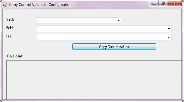

' Postconditions:
' 1. Displays the Copy Control Values to Configurations dialog box.
'    a. Select a vault view.
'       Folder is set to the root folder.
'    b. Select a file that has a data card with two or more configurations.
'    c. Displays the data card.
'    d. Click Copy Control Values.
'       Copies the value set in Preconditions step 5 to all configurations.
' 2. Close the dialog box.
' 3. Inspect the control values in all of the configurations of the data card.

Private Sub DoBtn_Click(ByVal sender As ObjectByVal e As EventArgsHandles DoBtn.Click
Dim i As Integer = FoldersComboBox.SelectedIndex
Dim edmFolder As IEdmFolder5 = oFoldersArray(i)
i = FilesComboBox.SelectedIndex
Dim edmFile As IEdmFile14 = DirectCast(oFileArray(i), IEdmFile14)
Dim cfgList As New List(Of String)()
Dim configLst As EdmStrLst5 = edmFile.GetConfigurations()
Dim cfgPos As IEdmPos5 = configLst.GetHeadPosition()
Do While Not cfgPos.IsNull
Dim configName As String = configLst.GetNext(cfgPos)
cfgList.Add(configName)
Loop
For Each configName As String In cfgList
' Move variable values from "@" to configName
edmFile.GenerateDefaultConfigValues(edmFile.ID"@", configName, ""False)
Next configName
ShowDataCard()
End Sub

' DoBtn
Me.DoBtn.Location = New System.Drawing.Point(223, 108)
Me.DoBtn.Name = "DoBtn"
Me.DoBtn.Size = New System.Drawing.Size(271, 23)
Me.DoBtn.TabIndex = 0
Me.DoBtn.Text = "Copy Control Values"
Me.DoBtn.UseVisualStyleBackColor = True

Me.Text = "Copy Control Values to Configurations"
