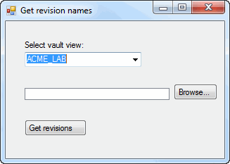

' Postconditions:
' 1. Displays the Get revision names dialog box.
' 2. Select a vault view.
' 3. Click Browse.
' 4. Displays the Select a file dialog box.
'    a. Click the file identified in Preconditions step 4 in the
'       selected vault.
'    b. Click Open to display the selected file's path and file
'       name in the Get revision names dialog box.
' 5. Click Get revisions.
' 6. Displays a message box listing the names of the revisions
'    for the selected file. Click OK to close the message box.
' 7. Displays a message box showing the revision to which the file
'    was rolled back and the current version. Click OK to close the
'    message box.
' 8. Close the Get revision names dialog box.

        'Form1
        Me.AutoScaleDimensions = New System.Drawing.SizeF(6.0!, 13.0!)
        Me.AutoScaleMode = System.Windows.Forms.AutoScaleMode.Font
        Me.ClientSize = New System.Drawing.Size(311, 195)
        Me.Controls.Add(Me.RevisionButton)
        Me.Controls.Add(Me.BrowseButton)
        Me.Controls.Add(Me.FileListBox)
        Me.Controls.Add(Me.VaultsComboBox)
        Me.Controls.Add(Me.VaultsLabel)
        Me.Name = "Form1"
        Me.Text = "Get revision names"
        Me.ResumeLayout(False)
        Me.PerformLayout()
