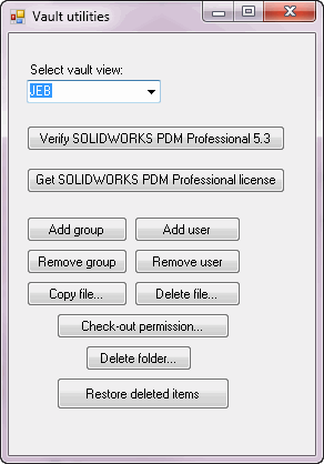

' Postconditions:
' 1. Displays the Vault utilities dialog box.
'    a. Select a vault view.
'    b. Click Verify SOLIDWORKS PDM Professional 5.3
'       1. Displays message about the installed version.
'       2. Click OK.
'    c. Click Get SOLIDWORKS Professional PDM licenses.
'       1. Displays a message with the installed licenses.
'       2. Click OK.
'    d. Click Add group.
'       1. Displays a message that group, My Group, is created.
'       2. Click OK.
'    e. Click Add user.
'       1. Displays a message that user, Temp, is created.
'       2. Click OK.
'    f. Click Remove group.
'       1. Displays a message with the removal status.
'       2. Click OK.
'    g. Click Remove user.
'       2. Click OK.
'    h. Click Copy file.
'       1. In the Open dialog, click a vault file.
'       2. Click Open.
'       3. In the Select Folder dialog, click a folder to which to copy
'          the selected file.
'       4. Click OK.
'       5. Displays a message with the file copy status.
'       6. Click OK.
'    i. Click Delete file.
'       1. In the Select Files to Delete dialog box, click a vault file
'          to delete.
'       2. Click Open.
'       3. Displays a message with the file deletion status.
'       4. Click OK.
'    j. Click Check-out permission.
'       1. In the Open dialog, click a file for which to get the check-out
'          permission.
'       2. Click Open.
'       3. Displays a message with the user's permission.
'       4. Click OK.
'    k. Click Delete folder.
'       1. In the Select Folder dialog, click an empty vault folder to delete.
'       2. Click OK.
'       3. Displays a message with the status of the folder deletion.
'       4. Click OK.
'    l. Click Restore deleted items.
'       1. In the Select Folder dialog, click the folder from which you deleted
'          a file in step 1i.
'       2. Click OK.
'       3. Displays a message with the status of the folder restoration.
'       4. Click OK.

        Me.VaultsLabel = New System.Windows.Forms.Label()
        Me.VaultsComboBox = New System.Windows.Forms.ComboBox()
        Me.Button1 = New System.Windows.Forms.Button()
        Me.Button2 = New System.Windows.Forms.Button()
        Me.Button3 = New System.Windows.Forms.Button()
        Me.Button4 = New System.Windows.Forms.Button()
        Me.Button5 = New System.Windows.Forms.Button()
        Me.Button6 = New System.Windows.Forms.Button()
        Me.Button7 = New System.Windows.Forms.Button()
        Me.Button8 = New System.Windows.Forms.Button()
        Me.Button9 = New System.Windows.Forms.Button()
        Me.Button10 = New System.Windows.Forms.Button()
        Me.Button11 = New System.Windows.Forms.Button()
        Me.OpenFileDialog1 = New System.Windows.Forms.OpenFileDialog()
        Me.SuspendLayout()
        'VaultsLabel
        Me.VaultsLabel.AutoSize = True
        Me.VaultsLabel.Location = New System.Drawing.Point(13, 26)
        Me.VaultsLabel.Name = "VaultsLabel"
        Me.VaultsLabel.Size = New System.Drawing.Size(94, 13)
        Me.VaultsLabel.TabIndex = 0
        Me.VaultsLabel.Text = " Select vault view:"
        'VaultsComboBox
        Me.VaultsComboBox.FormattingEnabled = True
        Me.VaultsComboBox.Location = New System.Drawing.Point(16, 42)
        Me.VaultsComboBox.Name = "VaultsComboBox"
        Me.VaultsComboBox.Size = New System.Drawing.Size(121, 21)
        Me.VaultsComboBox.TabIndex = 1
        'Button1
        Me.Button1.Location = New System.Drawing.Point(16, 223)
        Me.Button1.Name = "Button1"
        Me.Button1.Size = New System.Drawing.Size(91, 23)
        Me.Button1.TabIndex = 6
        Me.Button1.Text = "Copy file..."
        Me.Button1.UseVisualStyleBackColor = True
        'Button2
        Me.Button2.Location = New System.Drawing.Point(113, 223)
        Me.Button2.Name = "Button2"
        Me.Button2.Size = New System.Drawing.Size(96, 23)
        Me.Button2.TabIndex = 7
        Me.Button2.Text = "Delete file..."
        Me.Button2.UseVisualStyleBackColor = True
        'Button3
        Me.Button3.Location = New System.Drawing.Point(69, 281)
        Me.Button3.Name = "Button3"
        Me.Button3.Size = New System.Drawing.Size(96, 23)
        Me.Button3.TabIndex = 8
        Me.Button3.Text = "Delete folder..."
        Me.Button3.UseVisualStyleBackColor = True
        'Button4
        Me.Button4.Location = New System.Drawing.Point(43, 252)
        Me.Button4.Name = "Button4"
        Me.Button4.Size = New System.Drawing.Size(156, 23)
        Me.Button4.TabIndex = 9
        Me.Button4.Text = "Check-out permission..."
        Me.Button4.UseVisualStyleBackColor = True
        'Button5
        Me.Button5.Location = New System.Drawing.Point(16, 83)
        Me.Button5.Name = "Button5"
        Me.Button5.Size = New System.Drawing.Size(233, 23)
        Me.Button5.TabIndex = 10
        Me.Button5.Text = "Verify SOLIDWORKS PDM Professional 5.3"
        Me.Button5.UseVisualStyleBackColor = True
        'Button6
        Me.Button6.Location = New System.Drawing.Point(16, 121)
        Me.Button6.Name = "Button6"
        Me.Button6.Size = New System.Drawing.Size(233, 23)
        Me.Button6.TabIndex = 11
        Me.Button6.Text = "Get SOLIDWORKS PDM Professional licenses"
        Me.Button6.UseVisualStyleBackColor = True
        'Button7
        Me.Button7.Location = New System.Drawing.Point(16, 165)
        Me.Button7.Name = "Button7"
        Me.Button7.Size = New System.Drawing.Size(91, 23)
        Me.Button7.TabIndex = 12
        Me.Button7.Text = "Add group"
        Me.Button7.UseVisualStyleBackColor = True
        'Button8
        Me.Button8.Location = New System.Drawing.Point(16, 194)
        Me.Button8.Name = "Button8"
        Me.Button8.Size = New System.Drawing.Size(91, 23)
        Me.Button8.TabIndex = 13
        Me.Button8.Text = "Remove group"
        Me.Button8.UseVisualStyleBackColor = True
        'Button9
        Me.Button9.Location = New System.Drawing.Point(113, 165)
        Me.Button9.Name = "Button9"
        Me.Button9.Size = New System.Drawing.Size(96, 23)
        Me.Button9.TabIndex = 14
        Me.Button9.Text = "Add user"
        Me.Button9.UseVisualStyleBackColor = True
        'Button10
        Me.Button10.Location = New System.Drawing.Point(113, 194)
        Me.Button10.Name = "Button10"
        Me.Button10.Size = New System.Drawing.Size(96, 23)
        Me.Button10.TabIndex = 15
        Me.Button10.Text = "Remove user"
        Me.Button10.UseVisualStyleBackColor = True
        'Button11
        Me.Button11.Location = New System.Drawing.Point(43, 310)
        Me.Button11.Name = "Button11"
        Me.Button11.Size = New System.Drawing.Size(156, 29)
        Me.Button11.TabIndex = 16
        Me.Button11.Text = "Restore deleted items"
        Me.Button11.UseVisualStyleBackColor = True
        'OpenFileDialog1
        Me.OpenFileDialog1.FileName = "OpenFileDialog1"
        'Form1
        Me.AutoScaleDimensions = New System.Drawing.SizeF(6.0!, 13.0!)
        Me.AutoScaleMode = System.Windows.Forms.AutoScaleMode.Font
        Me.ClientSize = New System.Drawing.Size(276, 330)
        Me.Controls.Add(Me.Button11)
        Me.Controls.Add(Me.Button10)
        Me.Controls.Add(Me.Button9)
        Me.Controls.Add(Me.Button8)
        Me.Controls.Add(Me.Button7)
        Me.Controls.Add(Me.Button6)
        Me.Controls.Add(Me.Button5)
        Me.Controls.Add(Me.Button4)
        Me.Controls.Add(Me.Button3)
        Me.Controls.Add(Me.Button2)
        Me.Controls.Add(Me.Button1)
        Me.Controls.Add(Me.VaultsComboBox)
        Me.Controls.Add(Me.VaultsLabel)
        Me.Name = "Form1"
        Me.Text = "Vault utilities"
        Me.ResumeLayout(False)
        Me.PerformLayout()
    End Sub
#End Region
