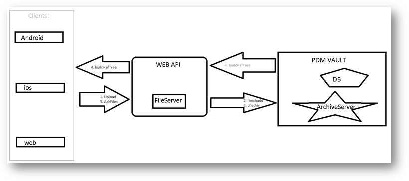

Background
The SOLIDWORKS PDM Professional Web API is an extension of Microsoft's ASP.NET Web API which is a framework that allows you to create Representational State Transfer (REST) applications on the .NET Framework.
If you are not familiar with REST, then please google:
  • Representational state transfer (REST)
  • ASP.NET REST APIs with .NET and C#
Hypertext Transfer Protocol (HTTP) enables communication between clients and servers through a request-response protocol.
If you are not familiar with HTTP, then please google:
  • HTTP Methods
Your web service application can authenticate logged-in users and set up JSON Web Tokens (JWT) Bearer tokens to securely authorize and restrict API access. You must obtain a bearer token to send with most HTTP requests of the PDM Pro Web API.
