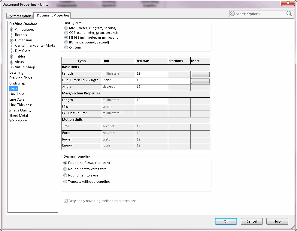

Setting |
Get/Set Methods |
Return Value or <Value> |
Comments |
Unit system |
IModelDocExtension::GetUserPreferenceInteger(swUserPreferenceIntegerValue_e.swUnitSystem,
swUserPreferenceOption_e.swDetailingNoOptionSpecified)
IModelDocExtension::SetUserPreferenceInteger(swUserPreferenceIntegerValue_e.swUnitSystem,
swUserPreferenceOption_e.swDetailingNoOptionSpecified, swUnitSystem_e.<Value>) |
See
swUnitSystem_e
for valid options |
Specifies type of system unit |
IModelDocExtension::SetUserPreferenceInteger(swUserPreferenceIntegerValue_e.swUnitsForceDecimalPlaces,
swUserPreferenceOption_e.swDetailingNoOptionSpecified, <Value>) |
Integer value (0 - 8) |
Specifies the number of decimal places for swUnitsForce |
Motion Analysis - Power - Unit |
IModelDocExtension::GetUserPreferenceInteger(swUserPreferenceIntegerValue_e.swUnitsPowerUnits,
IModelDocExtension::SetUserPreferenceInteger(swUserPreferenceIntegerValue_e.swUnitsPowerUnits,
swUserPreferenceOption_e.swDetailingNoOptionSpecified, swUnitsPowerUnit_e.<Value>) |
See swUnitsPowerUnit_e
for valid options |
Specifies type of power unit.
NOTE: You can only set this option when swUnitSystem_e
is swUnitSytem_Custom; Otherwise, FALSE is returned |
Motion Analysis - Power - Decimals |
IModelDocExtension::GetUserPreferenceInteger(swUserPreferenceIntegerValue_e.swUnitsPowerDecimalPlaces,
IModelDocExtension::SetUserPreferenceInteger(swUserPreferenceIntegerValue_e.swUnitsPowerDecimalPlaces,
Specifies the number of decimal places for swUnitsPower |
Motion Analysis - Energy - Unit |
IModelDocExtension::GetUserPreferenceInteger(swUserPreferenceIntegerValue_e.swUnitsEnergyUnits,
IModelDocExtension::SetUserPreferenceInteger(swUserPreferenceIntegerValue_e.swUnitsEnergyUnits,
swUserPreferenceOption_e.swDetailingNoOptionSpecified, swUnitsEnergyUnit_e.<Value>) |
See swUnitsEnergyUnit_e
for valid options |
Specifies the type of energy units.
Motion Analysis - Energy - Decimals |
IModelDocExtension::GetUserPreferenceToggle(swUserPreferenceToggle_e.swUnitsEnergyDecimalPlaces,
IModelDocExtension::SetUserPreferenceToggle(swUserPreferenceToggle_e.swUnitsEnergyDecimalPlaces,
Specifies the number of decimal places for swUnitsEnergy |
Decimal rounding -
- Round half away from zero
- Round half towards zero
- Round half to even
- Truncate without rounding
IModelDocExtension::GetUserPreferenceInteger(swUserPreferenceIntegerValue_e.swUnitsDecimalRounding,
IModelDocExtension::SetUserPreferenceInteger(swUserPreferenceIntegerValue_e.swUnitsDecimalRounding,
swUserPreferenceOption_e.swDetailingNoOptionSpecified, swUnitsDecimalRounding_e.<Value>) |
See
swUnitsDecimalRounding_e for valid options |
Specifies decimal rounding method |
Only apply rounding method to dimensions |
IModelDocExtension::GetUserPreferenceToggle(swUserPreferenceToggle_e.swDetailingNoDimSpecificOptionSpecified,
IModelDocExtension::SetUserPreferenceToggle(swUserPreferenceToggle_e.swDetailingNoDimSpecificOptionSpecified,
Boolean value |
Specifies whether to apply the
specified decimal rounding method to:
- any numeric display where
rounding occurs, including dialogs.
- or -
- dimensions on their tolerances, including dimensions whose values are derived from equations.
NOTE: Check box is not available if
Round half away from zero is selected.
