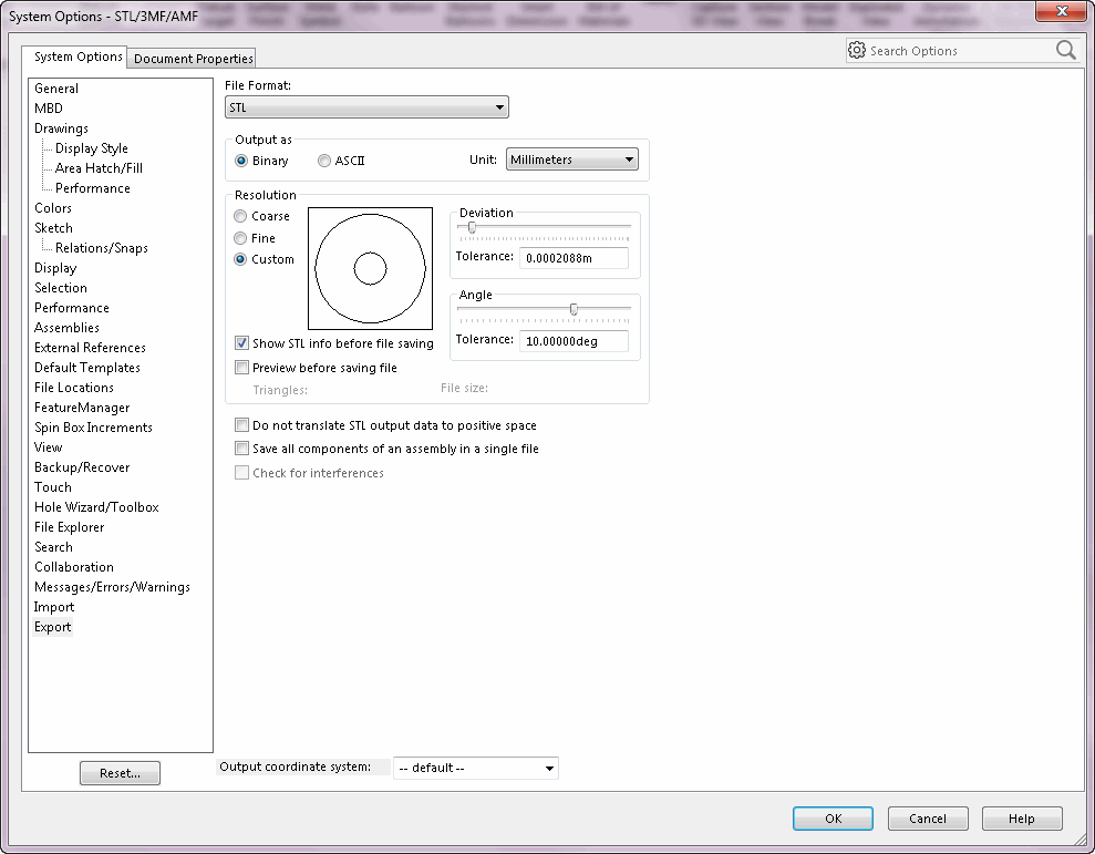

System Options > Export > STL
This topic contains two tables. The information in the table:
  • appearing immediately after the dialog corresponds to the settings on that dialog.
  • titled Obsolete Enumerators contains enumerators that previously appeared on the dialog but are now obsolete.
To display the dialog:
Click Tools > Options > System Options > Export > STL in File Format.
- or -
  1. Click File > Save As.
  2. In Save as type, select STL.
  3. Click Options.
Setting
Get/Set Methods
Return Value
or
<Value>
or
<OnFlag>
Comment
Output as - Binary
ISldWorks::GetUserPreferenceToggle(swUserPreferenceToggle_e.swSTLBinaryFormat)
ISldWorks::SetUserPreferenceToggle(swUserPreferenceToggle_e.swSTLBinaryFormat, <OnFlag>)
True
Output as - ASCII
False
Output as - Unit
ISldWorks::GetUserPreferenceIntegerValue(swUserPreferenceIntegerValue_e.swExportStlUnits)
ISldWorks::SetUserPreferenceIntegerValue(swUserPreferenceIntegerValue_e.swExportStlUnits, swLengthUnit_e.<Value>)
Valid options as defined in swLengthUnit_e:
  • 0 = swMM (millimeters)
  • 1 = swCM (centimeters)
  • 2 = swMETER
  • 3 = swINCHES
  • 4 = swFEET
Resolution -
  • Coarse
  • Fine
  • Custom
ISldWorks::GetUserPreferenceIntegerValue(swUserPreferenceIntegerValue_e.swSTLQuality)
ISldWorks::SetUserPreferenceIntegerValue(swUserPreferenceIntegerValue_e.swSTLQuality, swSTLQuality_e.<Value>)
See swSTLQuality_e for valid options
Specifies the resolution of the output for STL files
Resolution - Deviation - Tolerance
ISldWorks::GetUserPreferenceDoubleValue(swUserPreferenceDoubleValue_e.swSTLDeviation)
ISldWorks::SetUserPreferenceDoubleValue(swUserPreferenceDoubleValue_e.swSTLDeviation, <Value>)
Double value
Specifies deviation tolerance, which controls whole-part tessellation; lower numbers generate files with greater whole-part accuracy
Resolution - Angle - Tolerance
ISldWorks::GetUserPreferenceDoubleValue(swUserPreferenceDoubleValue_e.swSTLAngleTolerance)
ISldWorks::SetUserPreferenceDoubleValue(swUserPreferenceDoubleValue_e.swSTLAngleTolerance, <Value>)
Double value
Specifies angle tolerance, which controls smaller detail tessellation; lower numbers generate files with greater small-detail accuracy, but those files take longer to generate
Resolution - Show STL info before file saving
ISldWorks::GetUserPreferenceToggle(swUserPreferenceToggle_e.swSTLShowInfoOnSave)
ISldWorks::SetUserPreferenceToggle(swUserPreferenceToggle_e.swSTLShowInfoOnSave, <OnFlag>)
Boolean value
Specifies whether to show STL information before saving the file
Resolution - Preview before saving file
ISldWorks::GetUserPreferenceToggle(swUserPreferenceToggle_e.swSTLPreview)
ISldWorks::SetUserPreferenceToggle(swUserPreferenceToggle_e.swSTLPreview, <OnFlag>)
Boolean value
Specifies whether faceted model preview is displayed in the graphics area
Do not translate STL output data to positive space
ISldWorks::GetUserPreferenceToggle(swUserPreferenceToggle_e.swSTLDontTranslateToPositive)
ISldWorks::SetUserPreferenceToggle(swUserPreferenceToggle_e.swSTLDontTranslateToPositive, <OnFlag>)
Boolean value
Specifies whether exported parts maintain original position in global space, relative to origin
Save all components of an assembly in a single file
ISldWorks::GetUserPreferenceToggle(swUserPreferenceToggle_e.swSTLComponentsIntoOneFile)
ISldWorks::SetUserPreferenceToggle(swUserPreferenceToggle_e.swSTLComponentsIntoOneFile, <OnFlag>)
Boolean value
Specifies whether to save the assembly and its components to a single file
Check for interferences
ISldWorks::GetUserPreferenceToggle(swUserPreferenceToggle_e.swSTLCheckForInterference)
ISldWorks::SetUserPreferenceToggle(swUserPreferenceToggle_e.swSTLCheckForInterference, <OnFlag>)
Boolean value
Specifies whether to check for interference prior to saving assembly document; swUserPreferenceToggle_e.swSTLComponentsIntoOneFile must be set to true
Output coordinate system
ISldWorks::GetUserPreferenceStringValue(swUserPreferenceStringValue_e.swExportOutputCoordinateSystem)
ISldWorks::SetUserPreferenceStringValue(swUserPreferenceStringValue_e.swExportOutputCoordinateSystem, <Value>)
String value
