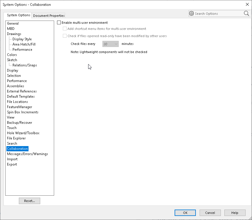

This topic contains two tables. The information in the table:
- appearing immediately after the dialog corresponds to the settings on that dialog.
- titled Obsolete
Enumerators contains enumerators that previously appeared on
the dialog but are now obsolete or have been moved to another location.
THe Collaboration settings are not supported in SOLIDWORKS Connected.
Setting |
Get/Set Methods |
Return Value
or
<Value>
or
<OnFlag> |
Comment |
Enable multi-user environment (Not supported in SOLIDWORKS Connected) |
ISldWorks::GetUserPreferenceToggle(swUserPreferenceToggle_e.swCollabEnableMultiuser)
ISldWorks::SetUserPreferenceToggle(swUserPreferenceToggle_e.swCollabEnableMultiuser,
<OnFlag>) |
Boolean value |
Specifies whether to enable
multi-user environment |
Add shortcut menu items for multi-user environment (Not supported in
ISldWorks::GetUserPreferenceToggle(swUserPreferenceToggle_e.swCollabAddShortcutMenuItems)
ISldWorks::SetUserPreferenceToggle(swUserPreferenceToggle_e.swCollabAddShortcutMenuItems,
<OnFlag>) |
Boolean value |
Specifies whether to add shortcut menu items for multi-user environment |
Check if files opened read-only have been modified by other users (Not
ISldWorks::GetUserPreferenceToggle(swUserPreferenceToggle_e.swCollabCheckReadOnlyModifiedByOthers)
ISldWorks::SetUserPreferenceToggle(swUserPreferenceToggle_e.swCollabCheckReadOnlyModifiedByOthers,
<OnFlag>) |
Boolean value |
Specifies whether to check if files opened read-only have been modified
by others; works with swUserPreferenceIntegerValue_e.swCollabCheckReadOnlyModifiedInterval |
Check files every <n>
minutes (Not supported in SOLIDWORKS Connected) |
ISldWorks::GetUserPreferenceIntegerValue(wUserPreferenceIntegerValue_e.swCollabCheckReadOnlyModifiedInterval)
ISldWorks::SetUserPreferenceIntegerValue(wUserPreferenceIntegerValue_e.swCollabCheckReadOnlyModifiedInterval,
swCollabCheckReadOnlyModifiedInterval_e .<Value>)
See swCollabCheckReadOnlyModifiedInterval_e
for valid options |
Works with swUserPreferenceToggle_e.swCollabCheckReadOnlyModifiedByOthers |
