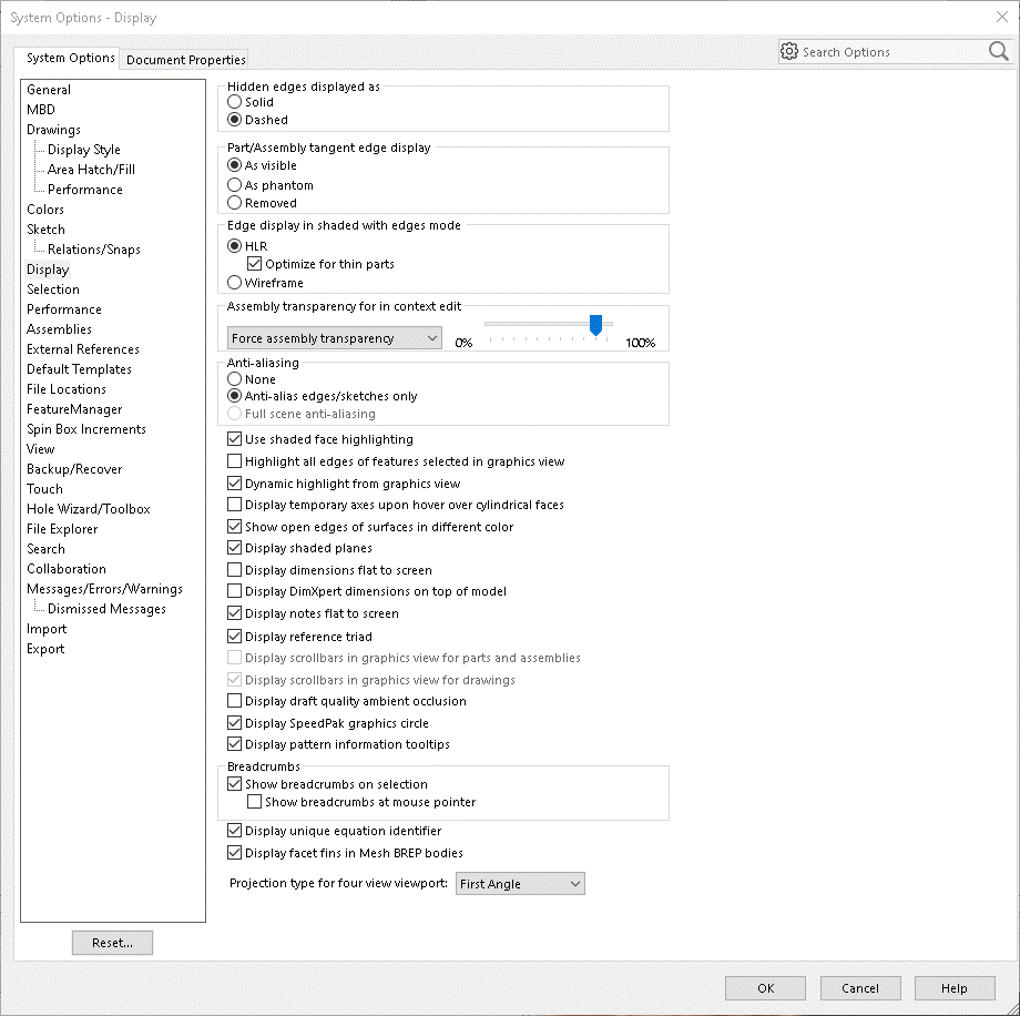

System Options > Display
This topic contains two tables. The information in the table:
  • appearing immediately after the screen capture of the dialog corresponds to the settings on that dialog.

Hidden edges displayed as - Solid
ISldWorks::GetUserPreferenceIntegerValue(swUserPreferenceIntegerValue_e.swEdgesHiddenEdgeDisplay)
ISldWorks::SetUserPreferenceIntegerValue(swUserPreferenceIntegerValue_e.swEdgesHiddenEdgeDisplay, swEdgesHiddenEdgeDisplay_e.swEdgesHiddenEdgeDisplaySolid)
Hidden edges displayed as - Dashed
ISldWorks::SetUserPreferenceIntegerValue(swUserPreferenceIntegerValue_e.swEdgesHiddenEdgeDisplay, swEdgesHiddenEdgeDisplay_e.swEdgesHiddenEdgeDisplayDashed)
Part/Assembly tangent edge display - As visible
ISldWorks::GetUserPreferenceIntegerValue(swUserPreferenceIntegerValue_e.swEdgesTangentEdgeDisplay)
ISldWorks::SetUserPreferenceIntegerValue(swUserPreferenceIntegerValue_e.swEdgesTangentEdgeDisplay, swEdgesTangentEdgeDisplay_e.swEdgesTangentEdgeDisplayVisible)
Part/Assembly tangent edge display - As phantom
ISldWorks::SetUserPreferenceIntegerValue(swUserPreferenceIntegerValue_e.swEdgesTangentEdgeDisplay, swEdgesTangentEdgeDisplay_e.swEdgesTangentEdgeDisplayPhantom)
Part/Assembly tangent edge display - Removed
ISldWorks::SetUserPreferenceIntegerValue(swUserPreferenceIntegerValue_e.swEdgesTangentEdgeDisplay, swEdgesTangentEdgeDisplay_e.swEdgesTangentEdgeDisplayRemoved)
Edge display in shaded with edges mode - HLR
ISldWorks::GetUserPreferenceIntegerValue(swUserPreferenceIntegerValue_e.swEdgesShadedModeDisplay)
ISldWorks::SetUserPreferenceIntegerValue(swUserPreferenceIntegerValue_e.swEdgesShadedModeDisplay, swEdgesShadedModeDisplay_e.swEdgesShadedModeDisplayHLR)
Edge display in shaded with edges mode - HLR - Optimize for thin parts
ISldWorks::GetUserPreferenceToggle(swUserPreferenceToggle_e.swEdgesShadedModeDisplayOptimizeForThinParts)
ISldWorks::SetUserPreferenceToggle(swUserPreferenceToggle_e.swEdgesShadedModeDisplayOptimizeForThinParts, <OnFlag>)
Boolean value
True to optimize for thin parts; valid only if Edge display in shaded with edges mode - HLR is set
Edge display in shaded with edges mode - Wireframe
ISldWorks::SetUserPreferenceIntegerValue(swUserPreferenceIntegerValue_e.swEdgesShadedModeDisplay, swEdgesShadedModeDisplay_e.swEdgesShadedModeDisplayWireframe)
Assembly transparency for in context edit - <selection box>
ISldWorks::GetUserPreferenceIntegerValue(swUserPreferenceIntegerValue_e.swEdgesInContextEditTransparencyType)
ISldWorks::SetUserPreferenceIntegerValue(swUserPreferenceIntegerValue_e.swEdgesInContextEditTransparencyType, swInContextEditTransparencyType_e.<Value>)
See swInContextEditTransparencyType_e for valid options
Assembly transparency for in context edit - <slider>
ISldWorks::GetUserPreferenceIntegerValue(swUserPreferenceIntegerValue_e.swEdgesInContextEditTransparency)
ISldWorks::SetUserPreferenceIntegerValue(swUserPreferenceIntegerValue_e.swEdgesInContextEditTransparency, <Value>)
Integer value between 0 and 100 indicating transparency
Anti-aliasing
ISldWorks::GetUserPreferenceIntegerValue(swUserPreferenceIntegerValue_e.swSystemOptionDisplayAntiAliasing)
ISldWorks::SetUserPreferenceIntegerValue(swUserPreferenceIntegerValue_e.swSystemOptionDisplayAntiAliasing, <Value>)
See swSystemOptionDisplayAntiAliasing_e for valid options
Specifies whether to smooth out jagged edges in Shaded With Edges, Wireframe, Hidden Lines Removed, and Hidden Lines Visible modes
Use shaded face highlighting
ISldWorks::GetUserPreferenceToggle(swUserPreferenceToggle_e.swUseShadedFaceHighlight)
ISldWorks::SetUserPreferenceToggle(swUserPreferenceToggle_e.swUseShadedFaceHighlight, <OnFlag>)
Boolean value
Highlight all edges of features selected in graphics view
ISldWorks::GetUserPreferenceToggle(swUserPreferenceToggle_e.swEdgesHighlightFeatureEdges)
ISldWorks::SetUserPreferenceToggle(swUserPreferenceToggle_e.swEdgesHighlightFeatureEdges, <OnFlag>)
Boolean value
Specifies whether all edges on selected feature are highlighted when feature selected
Dynamic highlight from graphics view
ISldWorks::GetUserPreferenceToggle(swUserPreferenceToggle_e.swEdgesDynamicHighlight)
ISldWorks::SetUserPreferenceToggle(swUserPreferenceToggle_e.swEdgesDynamicHighlight, <OnFlag>)
Boolean value
Specifies whether to highlight edges, faces, vertices, dimensions, annotations, and so on, in the graphics area when pointer moves across them
Display temporary axes upon hover over cylindrical faces
ISldWorks::GetUserPreferenceToggle(swUserPreferenceToggle_e.swDisplayTempAxesOnMouseHover)
ISldWorks::SetUserPreferenceToggle(swUserPreferenceToggle_e.swDisplayTempAxesOnMouseHover, <OnFlag>)
Boolean value
Show open edges of surfaces in different color
ISldWorks::GetUserPreferenceToggle(swUserPreferenceToggle_e.swEdgesOpenEdgesDifferentColor)
ISldWorks::SetUserPreferenceToggle(swUserPreferenceToggle_e.swEdgesOpenEdgesDifferentColor, <OnFlag>)
Boolean value
Specifies whether to differentiate between open edges of surface and any tangent edges or silhouette
Display shaded planes
ISldWorks::GetUserPreferenceToggle(swUserPreferenceToggle_e.swEdgesDisplayShadedPlanes)
ISldWorks::SetUserPreferenceToggle(swUserPreferenceToggle_e.swEdgesDisplayShadedPlanes, <OnFlag>)
Boolean value
Specifies whether to display transparent shaded planes with a wireframe edge that have different front and back colors
Display dimensions flat to screen
ISldWorks::GetUserPreferenceToggle(swUserPreferenceToggle_e.swDisplayDimensionsFlatToScreen)
ISldWorks::SetUserPreferenceToggle(swUserPreferenceToggle_e.swDisplayDimensionsFlatToScreen, <OnFlag>)
Boolean value
Specifies whether to display dimensions flat to screen
Display DimXpert dimensions on top of model
ISldWorks::GetUserPreferenceToggle(swUserPreferenceToggle_e.swDispDimXpertDimOnTopOfModel)
ISldWorks::SetUserPreferenceToggle(swUserPreferenceToggle_e.swDispDimXpertDimOnTopOfModel, <OnFlag>)
Boolean value
Display notes flat to screen
ISldWorks::GetUserPreferenceToggle(swUserPreferenceToggle_e.swDisplayNotesFlatToScreen)
ISldWorks::SetUserPreferenceToggle(swUserPreferenceToggle_e.swDisplayNotesFlatToScreen, <OnFlag>)
Boolean value
Specifies whether to display notes flat to screen
Display reference triad
ISldWorks::GetUserPreferenceToggle(swUserPreferenceToggle_e.swDisplayReferenceTriad)
ISldWorks::SetUserPreferenceToggle(swUserPreferenceToggle_e.swDisplayReferenceTriad, <OnFlag>)
Boolean value
Display scrollbars in graphics view for parts and assemblies
ISldWorks::GetUserPreferenceToggle(swUserPreferenceToggle_e.swDisplayScrollbarsInGraphicsViewPartsAndAssemblies)
ISldWorks::SetUserPreferenceToggle(swUserPreferenceToggle_e.swDisplayScrollbarsInGraphicsViewPartsAndAssemblies, <OnFlag>)
Boolean value
Display scrollbars in graphics view for drawings
ISldWorks::GetUserPreferenceToggle(swUserPreferenceToggle_e.swDisplayScrollbarsInGraphicsViewDrawings)
ISldWorks::SetUserPreferenceToggle(swUserPreferenceToggle_e.swDisplayScrollbarsInGraphicsViewDrawings, <OnFlag>)
Boolean value
Display draft quality ambient occlusion
ISldWorks::GetUserPreferenceToggle(swUserPreferenceToggle_e.swDraftQualityAmbientOcclusion)
ISldWorks::SetUserPreferenceToggle(swUserPreferenceToggle_e.swDraftQualityAmbientOcclusion, <OnFlag>)
Boolean value
Specifies whether to use global lighting that adds realism to models by controlling the attenuation of ambient light due to occluded areas; available in all scenes when you use RealView graphics
Display Speedpak graphics circle
ISldWorks::GetUserPreferenceToggle(swUserPreferenceToggle_e.swDisplaySpeedpakGraphicsCircle)
ISldWorks::SetUserPreferenceToggle(swUserPreferenceToggle_e.swDisplaySpeedpakGraphicsCircle, <OnFlag>)
Boolean value
Specifies whether to display Speedpak graphics circle
Display pattern information tooltips
ISldWorks::GetUserPreferenceToggle(swUserPreferenceToggle_e.swDisplayPatternInformationToolTips)
ISldWorks::SetUserPreferenceToggle(swUserPreferenceToggle_e.swDisplayPatternInformationToolTips, <OnFlag>)
Boolean value
Specifies whether to display pattern information tooltips
Breadcrumbs - Show breadcrumbs on selection
ISldWorks::GetUserPreferenceToggle(swUserPreferenceToggle_e.swShowBreadcrumbsOnSelection)
ISldWorks::SetUserPreferenceToggle(swUserPreferenceToggle_e.swShowBreadcrumbsOnSelection, <OnFlag>)
Boolean value
Specifies whether to show breadcrumbs on selection
Breadcrumbs - Show breadcrumbs at mouse pointer
ISldWorks::GetUserPreferenceToggle(swUserPreferenceToggle_e.swShowBreadcrumbsAtMousePointer)
ISldWorks::SetUserPreferenceToggle(swUserPreferenceToggle_e.swShowBreadcrumbsAtMousePointer, <OnFlag>)
Boolean value
Specifies whether to show breadcrumbs at the mouse pointer; valid only if Show breadcrumbs on selection is selected
Display facet fins in Mesh BREP bodies
ISldWorks::GetUserPreferenceToggle(swUserPreferenceToggle_e.swDisplayMeshBREPFacetFins)
ISldWorks::SetUserPreferenceToggle(swUserPreferenceToggle_e.swDisplayMeshBREPFacetFins, <OnFlag>)
Boolean value
