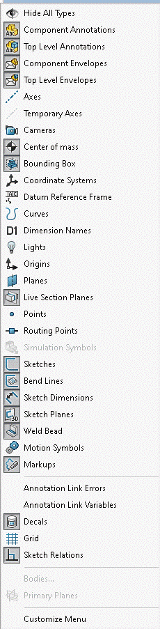

View > Hide / Show
Setting
Get/Set Methods
Return Value or <Value>
Comment
All Annotations
IModelDocExtension::GetUserPreferenceToggle(swUserPreferenceToggle_e.swDisplayAllAnnotations, swUserPreferenceOption_e.swDetailingNoOptionSpecified)
IModelDocExtension::SetUserPreferenceToggle(swUserPreferenceToggle_e.swDisplayAllAnnotations, swUserPreferenceOption_e.swDetailingNoOptionSpecified, <Value>)
Boolean value
Specifies whether to display all annotations; for assemblies only
Component Envelopes
IModelDocExtension::GetUserPreferenceToggle(swUserPreferenceToggle_e.swDisplayComponentEnvelopes, swUserPreferenceOption_e.swDetailingNoOptionSpecified)
IModelDocExtension::SetUserPreferenceToggle(swUserPreferenceToggle_e.swDisplayComponentEnvelopes, swUserPreferenceOption_e.swDetailingNoOptionSpecified, <Value>)
Boolean value
For assemblies only
Top Level Envelopes
IModelDocExtension::GetUserPreferenceToggle(swUserPreferenceToggle_e.swDisplayTopLevelEnvelopes, swUserPreferenceOption_e.swDetailingNoOptionSpecified)
IModelDocExtension::SetUserPreferenceToggle(swUserPreferenceToggle_e.swDisplayTopLevelEnvelopes, swUserPreferenceOption_e.swDetailingNoOptionSpecified, <Value>)
Boolean value
For assemblies only
Axes
IModelDocExtension::GetUserPreferenceToggle(swUserPreferenceToggle_e.swDisplayAxes, swUserPreferenceOption_e.swDetailingNoOptionSpecified)
IModelDocExtension::SetUserPreferenceToggle(swUserPreferenceToggle_e.swDisplayAxes, swUserPreferenceOption_e.swDetailingNoOptionSpecified, <Value>)
Boolean value
Specifies whether to display axes
Temporary Axes
IModelDocExtension::GetUserPreferenceToggle(swUserPreferenceToggle_e.swDisplayTemporaryAxes, swUserPreferenceOption_e.swDetailingNoOptionSpecified)
IModelDocExtension::SetUserPreferenceToggle(swUserPreferenceToggle_e.swDisplayTemporaryAxes, swUserPreferenceOption_e.swDetailingNoOptionSpecified, <Value>)
Boolean value
Specifies whether to display temporary axes
Cameras
IModelDocExtension::GetUserPreferenceToggle(swUserPreferenceToggle_e.swDisplayCameras, swUserPreferenceOption_e.swDetailingNoOptionSpecified)
IModelDocExtension::SetUserPreferenceToggle(swUserPreferenceToggle_e.swDisplayCameras, swUserPreferenceOption_e.swDetailingNoOptionSpecified, <Value>)
Boolean value
Specifies whether to display cameras
Component Annotations
IModelDocExtension::GetUserPreferenceToggle(swUserPreferenceToggle_e.swDisplayCompAnnotations, swUserPreferenceOption_e.swDetailingNoOptionSpecified)
IModelDocExtension::SetUserPreferenceToggle(swUserPreferenceToggle_e.swDisplayCompAnnotations, swUserPreferenceOption_e.swDetailingNoOptionSpecified, <Value>)
Boolean value
Specifies whether to display component annotations; for assemblies only
Coordinate Systems
IModelDocExtension::GetUserPreferenceToggle(swUserPreferenceToggle_e.swDisplayCoordSystems, swUserPreferenceOption_e.swDetailingNoOptionSpecified)
IModelDocExtension::SetUserPreferenceToggle(swUserPreferenceToggle_e.swDisplayCoordSystems, swUserPreferenceOption_e.swDetailingNoOptionSpecified, <Value>)
Boolean value
Specifies whether to display coordinate systems
Curves
IModelDocExtension::GetUserPreferenceToggle(swUserPreferenceToggle_e.swDisplayCurves, swUserPreferenceOption_e.swDetailingNoOptionSpecified)
IModelDocExtension::SetUserPreferenceToggle(swUserPreferenceToggle_e.swDisplayCurves, swUserPreferenceOption_e.swDetailingNoOptionSpecified, <Value>)
Boolean value
Specifies whether to display curves
Datum Reference Frame
IModelDocExtension::GetUserPreferenceToggle(swUserPreferenceToggle_e.swDisplayDatumCoordSystems, swUserPreferenceOption_e.swDetailingNoOptionSpecified)
IModelDocExtension::SetUserPreferenceToggle(swUserPreferenceToggle_e.swDisplayDatumCoordSystems, swUserPreferenceOption_e.swDetailingNoOptionSpecified, <Value>)
Boolean value
Specifies whether to display datum coordinate systems
Dimension Names
IModelDocExtension::GetUserPreferenceToggle(swUserPreferenceToggle_e.swShowDimensionNames, swUserPreferenceOption_e.swDetailingNoOptionSpecified)
IModelDocExtension::SetUserPreferenceToggle(swUserPreferenceToggle_e.swShowDimensionNames, swUserPreferenceOption_e.swDetailingNoOptionSpecified, <Value>)
Boolean value
Specifies whether to display dimension names
Hide All Types
IModelDocExtension::GetUserPreferenceToggle(swUserPreferenceToggle_e.swViewDisplayHideAllTypes, swUserPreferenceOption_e.swDetailingNoOptionSpecified)
IModelDocExtension::SetUserPreferenceToggle(swUserPreferenceToggle_e.swViewDisplayHideAllTypes, swUserPreferenceOption_e.swDetailingNoOptionSpecified, <Value>)
Boolean value
Specifies whether to hide all items in table
Lights
IModelDocExtension::GetUserPreferenceToggle(swUserPreferenceToggle_e.swDisplayLights, swUserPreferenceOption_e.swDetailingNoOptionSpecified)
IModelDocExtension::SetUserPreferenceToggle(swUserPreferenceToggle_e.swDisplayLights, swUserPreferenceOption_e.swDetailingNoOptionSpecified, <Value>)
Boolean value
Specifies whether to display lights
Live Section Planes
IModelDocExtension::GetUserPreferenceToggle(swUserPreferenceToggle_e.swDisplayLiveSections, swUserPreferenceOption_e.swDetailingNoOptionSpecified)
IModelDocExtension::SetUserPreferenceToggle(swUserPreferenceToggle_e.swDisplayLiveSections, swUserPreferenceOption_e.swDetailingNoOptionSpecified, <Value>)
Boolean value
Specifies whether to display live sections
Origins
IModelDocExtension::GetUserPreferenceToggle(swUserPreferenceToggle_e.swDisplayOrigins, swUserPreferenceOption_e.swDetailingNoOptionSpecified)
IModelDocExtension::SetUserPreferenceToggle(swUserPreferenceToggle_e.swDisplayOrigins, swUserPreferenceOption_e.swDetailingNoOptionSpecified, <Value>)
Boolean value
Specifies whether to display origins
Parting Lines
IModelDocExtension::GetUserPreferenceToggle(swUserPreferenceToggle_e.swDisplayPartingLines, swUserPreferenceOption_e.swDetailingNoOptionSpecified)
IModelDocExtension::SetUserPreferenceToggle(swUserPreferenceToggle_e.swDisplayPartingLines, swUserPreferenceOption_e.swDetailingNoOptionSpecified, <Value>)
Boolean value
Specifies whether to display parting lines
Planes
IModelDocExtension::GetUserPreferenceToggle(swUserPreferenceToggle_e.swDisplayPlanes, swUserPreferenceOption_e.swDetailingNoOptionSpecified)
IModelDocExtension::SetUserPreferenceToggle(swUserPreferenceToggle_e.swDisplayPlanes, swUserPreferenceOption_e.swDetailingNoOptionSpecified, <Value>)
Boolean value
Specifies whether to display planes
Points
IModelDocExtension::GetUserPreferenceToggle(swUserPreferenceToggle_e.swDisplayReferencePoints2, swUserPreferenceOption_e.swDetailingNoOptionSpecified)
IModelDocExtension::SetUserPreferenceToggle(swUserPreferenceToggle_e.swDisplayReferencePoints2, swUserPreferenceOption_e.swDetailingNoOptionSpecified, <Value>)
Boolean value
Specifies whether to display reference points
Routing Points
IModelDocExtension::GetUserPreferenceToggle(swUserPreferenceToggle_e.swDisplayRoutePoints, swUserPreferenceOption_e.swDetailingNoOptionSpecified)
IModelDocExtension::SetUserPreferenceToggle(swUserPreferenceToggle_e.swDisplayRoutePoints, swUserPreferenceOption_e.swDetailingNoOptionSpecified, <Value>)
Boolean value
Specifies whether to display routing points
Sketches
IModelDocExtension::GetUserPreferenceToggle(swUserPreferenceToggle_e.swDisplaySketches, swUserPreferenceOption_e.swDetailingNoOptionSpecified)
IModelDocExtension::SetUserPreferenceToggle(swUserPreferenceToggle_e.swDisplaySketches, swUserPreferenceOption_e.swDetailingNoOptionSpecified, <Value>)
Boolean value
Specifies to display sketches
Bend Lines
IModelDocExtension::GetUserPreferenceToggle(swUserPreferenceToggle_e.swDisplayBendLines, swUserPreferenceOption_e.swDetailingNoOptionSpecified)
IModelDocExtension::SetUserPreferenceToggle(swUserPreferenceToggle_e.swDisplayBendLines, swUserPreferenceOption_e.swDetailingNoOptionSpecified, <Value>)
Boolean value
Simulation Symbols
IModelDocExtension::GetUserPreferenceToggle(swUserPreferenceToggle_e.swDisplaySimulationSymbol, swUserPreferenceOption_e.swDetailingNoOptionSpecified)
IModelDocExtension::SetUserPreferenceToggle(swUserPreferenceToggle_e.swDisplaySimulationSymbol, swUserPreferenceOption_e.swDetailingNoOptionSpecified, <Value>)
Boolean value
Specifies whether to display simulation symbols (for SOLIDWORKS Simulation only)
Sketch Dimensions
IModelDocExtension::GetUserPreferenceToggle(swUserPreferenceToggle_e.swHideShowSketchDimensions, swUserPreferenceOption_e.swDetailingNoOptionSpecified)
IModelDocExtension::SetUserPreferenceToggle(swUserPreferenceToggle_e.swHideShowSketchDimensions, swUserPreferenceOption_e.swDetailingNoOptionSpecified, <Value>)
Boolean value
Specifies whether to display sketch dimensions
Sketch Planes
IModelDocExtension::GetUserPreferenceToggle(swUserPreferenceToggle_e.swDisplaySketchPlanes, swUserPreferenceOption_e.swDetailingNoOptionSpecified)
IModelDocExtension::SetUserPreferenceToggle(swUserPreferenceToggle_e.swDisplaySketchPlanes, swUserPreferenceOption_e.swDetailingNoOptionSpecified, <Value>)
Boolean value
Specifies whether to display sketch planes
Weld Bead
IModelDocExtension::GetUserPreferenceToggle(swUserPreferenceToggle_e.swDisplayWeldBead, swUserPreferenceOption_e.swDetailingNoOptionSpecified)
IModelDocExtension::SetUserPreferenceToggle(swUserPreferenceToggle_e.swDisplayWeldBead, swUserPreferenceOption_e.swDetailingNoOptionSpecified, <Value>)
Boolean value
Specifies whether to display weld beads
Motion Symbols
IModelDocExtension::GetUserPreferenceToggle(swUserPreferenceToggle_e.swDisplayMotionSymbol, swUserPreferenceOption_e.swDetailingNoOptionSpecified)
IModelDocExtension::SetUserPreferenceToggle(swUserPreferenceToggle_e.swDisplayMotionSymbol, swUserPreferenceOption_e.swDetailingNoOptionSpecified, <Value>)
Boolean value
For assemblies only
Markups
IModelDocExtension::GetUserPreferenceToggle(swUserPreferenceToggle_e.swDisplayMarkups, swUserPreferenceOption_e.swDetailingNoOptionSpecified)
IModelDocExtension::SetUserPreferenceToggle(swUserPreferenceToggle_e.swDisplayMarkups, swUserPreferenceOption_e.swDetailingNoOptionSpecified, <Value>)
Boolean value
Decals
IModelDocExtension::GetUserPreferenceToggle(swUserPreferenceToggle_e.swDisplayDecals, swUserPreferenceOption_e.swDetailingNoOptionSpecified)
IModelDocExtension::SetUserPreferenceToggle(swUserPreferenceToggle_e.swDisplayDecals, swUserPreferenceOption_e.swDetailingNoOptionSpecified, <Value>)
Boolean value
Specifies whether to display decals
Grid
IModelDocExtension::GetUserPreferenceToggle(swUserPreferenceToggle_e.swGridDisplay, swUserPreferenceOption_e.swDetailingNoOptionSpecified)
IModelDocExtension::SetUserPreferenceToggle(swUserPreferenceToggle_e.swGridDisplay, swUserPreferenceOption_e.swDetailingNoOptionSpecified, <Value>)
Boolean value
Specifies whether to display a grid
Sketch Relations
IModelDocExtension::GetUserPreferenceToggle(swUserPreferenceToggle_e.swViewSketchRelations, swUserPreferenceOption_e.swDetailingNoOptionSpecified)
IModelDocExtension::SetUserPreferenceToggle(swUserPreferenceToggle_e.swViewSketchRelations, swUserPreferenceOption_e.swDetailingNoOptionSpecified, <Value>)
Boolean value
Specifies whether to display sketch relation symbols
