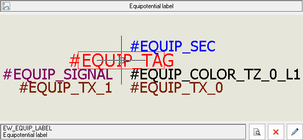

You can access equipotential labels and configure the symbols that
represent them.
To access equipotential labels, right-click a wire and click Show/hide
equipotential labels.
The equipotential label displays the equipotential number. Make sure that wire numbering is
active.
![](ubm1658416395421.image)
Equipotential labels are represented by a symbol and attributes that can display the data
or properties associated with the equipotential. You can right-click an equipotential label
to edit the equipotential properties and other parameters.
