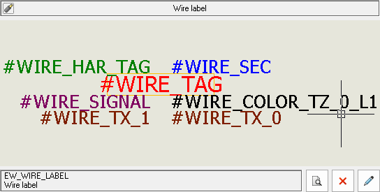

You can access wire labels and configure the symbols that represent
them.
To access wire labels, right-click a wire and click Show/hide wire
labels.
The wire label displays the wire number. Make sure that wire numbering is active.
![](ubm1658416395421.image)
Wire labels are represented by a symbol and attributes that can display the data or
properties associated with the wire. You can right-click a wire label to edit the wire
properties.
