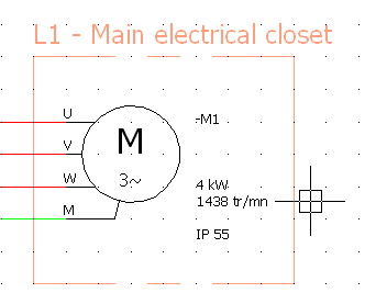

Location outlines let graphically show a (geographic) location on a drawing. The
location outline can be represented as a rectangle or created with polylines, but should
always be closed.

A drop-down list lets you select the type of outline (Thin, Double, and
Filled).
- Zig-Zag: SOLIWORKS Electrical inserts a zig-zag
line on the lower line of the rectangle to indicate that the whole
location is not drawn. This option is not available on location outlines
drawn in the form of polylines.
- Location label: Lets you insert the symbol
displayed in the dockable panel. This symbol corresponds with the symbol
saved in the electrical project configuration; if you want to insert
another symbol, click Other symbol.
A location label is automatically placed in the top part of the outline.
The location labels are represented by a symbol and attributes, which can
display the data or properties attached to the location. The location labels
have a context menu that lets you, among other things, edit the location
properties.
