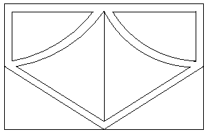

Use the following methods to create non-rectangular Viewports:
  • Convert a closed entity, such as a Circle, an Ellipse, a Spline, a Region, or a closed PolyLine into a Viewport.
  • Draw the Viewport boundaries in the same way as drawing a polyline.
You can combine Viewports of different shapes to create various Viewport configurations within a Sheet.
