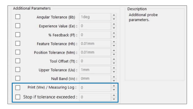

Additional Probe Cycle Parameters The Additional Probe Cycle Parameters dialog box contains options for Stop if tolerance exceeded and Print (Ww) / Measuring Log. Contents Stop If Tolerance Exceeded If a probe cycle goes beyond tolerance limits, the Stop if tolerance exceeded parameter specifies whether to interrupt the program and display the details of the violation. Print (Ww) / Measuring Log The Print (Ww) parameter is renamed to Print (Ww) / Measuring Log. Parent topicSOLIDWORKS CAM
