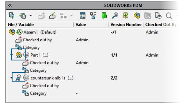

SOLIDWORKS PDM Add-in Enhancements (2024 SP1) When you save an assembly file as a part file, an internal component (saved as an external file in the vault), or a mirror component using the Save as command, a data card for the new file displays generating serial numbers and default values if set in the card. The SOLIDWORKS PDM add-in displays an icon overlay and supports all SOLIDWORKS PDM operations for components that are open in lightweight mode. You can enable the Automatically optimize resolved mode, hide lightweight mode option even when the SOLIDWORKS PDM add-in is active. Contents Handling Large Design Review (LDR) and Detailing Mode in the SOLIDWORKS PDM Add-in (2024 SP2) For assemblies opened in Large Design Review (LDR) mode and for drawings opened in Detailing mode, you can view the SOLIDWORKS files structure in the SOLIDWORKS PDM Task Pane (along with icons) similar to the FeatureManager design tree. Parent topicSOLIDWORKS PDM
