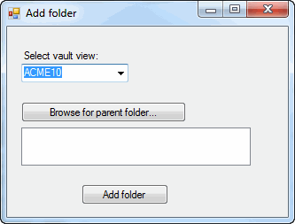

This example shows how to create a folder and set its data card and permissions.

' 1. Displays the Add folder dialog box.
'    a. Select a vault view.
'    b. Click Browse for parent folder
'       1. Locate and click a folder in the vault.
'       2. Click OK.
'    c. Click Add folder.
'       1.  Creates an IEdmFolderData5 object with:
'           * Folder user permissions for user, Engineer1.
'           * Folder group permissions for group, Administrators.
'           * File data card for .doc files.
'       2. Displays a message that folder, Temp, is added as a subfolder to
'          the folder clicked in Postconditions 1b1.
'       3. Click OK.

'Form1.Designer.vb
<Global.Microsoft.VisualBasic.CompilerServices.DesignerGenerated()> _
Partial Class Form1
    Inherits System.Windows.Forms.Form
    ''' <summary>
    ''' Required designer variable.
    ''' </summary>
    Private components As System.ComponentModel.IContainer = Nothing
    ''' <summary>
    ''' Clean up any resources being used.
    ''' </summary>
    ''' <param name="disposing">true if managed resources should be disposed; otherwise, false.</param>
    Protected Overrides Sub Dispose(ByVal disposing As Boolean)
        If disposing AndAlso (components IsNot NothingThen
            components.Dispose()
        End If
        MyBase.Dispose(disposing)
    End Sub
#Region "Windows Form Designer generated code"
    ''' <summary>
    ''' Required method for Designer support - do not modify
    ''' the contents of this method with the code editor.
    ''' </summary>
    Private Sub InitializeComponent()
        Me.VaultsLabel = New System.Windows.Forms.Label()
        Me.VaultsComboBox = New System.Windows.Forms.ComboBox()
        Me.BrowseButton = New System.Windows.Forms.Button()
        Me.ListBox = New System.Windows.Forms.ListBox()
        Me.AddFolder = New System.Windows.Forms.Button()
        Me.FolderBrowserDialog1 = New System.Windows.Forms.FolderBrowserDialog()
        Me.SuspendLayout()
        'VaultsLabel
        Me.VaultsLabel.AutoSize = True
        Me.VaultsLabel.Location = New System.Drawing.Point(13, 26)
        Me.VaultsLabel.Name = "VaultsLabel"
        Me.VaultsLabel.Size = New System.Drawing.Size(94, 13)
        Me.VaultsLabel.TabIndex = 0
        Me.VaultsLabel.Text = " Select vault view:"
        'VaultsComboBox
        Me.VaultsComboBox.FormattingEnabled = True
        Me.VaultsComboBox.Location = New System.Drawing.Point(16, 42)
        Me.VaultsComboBox.Name = "VaultsComboBox"
        Me.VaultsComboBox.Size = New System.Drawing.Size(121, 21)
        Me.VaultsComboBox.TabIndex = 1
        'BrowseButton
        Me.BrowseButton.Location = New System.Drawing.Point(16, 85)
        Me.BrowseButton.Name = "BrowseButton"
        Me.BrowseButton.Size = New System.Drawing.Size(186, 23)
        Me.BrowseButton.TabIndex = 3
        Me.BrowseButton.Text = "Browse for parent folder..."
        Me.BrowseButton.UseVisualStyleBackColor = True
        'ListBox
        Me.ListBox.FormattingEnabled = True
        Me.ListBox.HorizontalScrollbar = True
        Me.ListBox.Location = New System.Drawing.Point(16, 114)
        Me.ListBox.Name = "ListBox"
        Me.ListBox.Size = New System.Drawing.Size(259, 43)
        Me.ListBox.TabIndex = 4
        'AddFolder
        Me.AddFolder.Location = New System.Drawing.Point(84, 178)
        Me.AddFolder.Name = "AddFolder"
        Me.AddFolder.Size = New System.Drawing.Size(98, 23)
        Me.AddFolder.TabIndex = 5
        Me.AddFolder.Text = "Add folder"
        Me.AddFolder.UseVisualStyleBackColor = True
        'Form1
        Me.AutoScaleDimensions = New System.Drawing.SizeF(6.0!, 13.0!)
        Me.AutoScaleMode = System.Windows.Forms.AutoScaleMode.Font
        Me.ClientSize = New System.Drawing.Size(317, 215)
        Me.Controls.Add(Me.AddFolder)
        Me.Controls.Add(Me.ListBox)
        Me.Controls.Add(Me.BrowseButton)
        Me.Controls.Add(Me.VaultsComboBox)
        Me.Controls.Add(Me.VaultsLabel)
        Me.Name = "Form1"
        Me.Text = "Add folder"
        Me.ResumeLayout(False)
        Me.PerformLayout()
    End Sub
#End Region
    Friend WithEvents VaultsLabel As System.Windows.Forms.Label
    Friend WithEvents VaultsComboBox As System.Windows.Forms.ComboBox
    Friend WithEvents BrowseButton As System.Windows.Forms.Button
    Friend WithEvents ListBox As System.Windows.Forms.ListBox
    Friend WithEvents AddFolder As System.Windows.Forms.Button
    Friend WithEvents FolderBrowserDialog1 As System.Windows.Forms.FolderBrowserDialog
End Class
