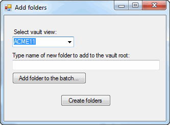

' Postconditions:
' 1. Displays the Add folders dialog box.
'    a. Select a vault view.
'    b. Type the name of a new folder to create in the root folder
'       of the vault.
'    c. Click Add folder to the batch.
'       1. Displays a message that the folder is added to the batch.
'       2. Click OK.
' 2. Repeat steps 1b-c repeatedly to add more folders to the batch.
' 3. Click Create folders.
'    a. Displays a message that the folder is created.
'    b. Click OK in each message box.
' 4. Close the Add folders dialog box.

    Private Sub InitializeComponent()
        Me.VaultsLabel = New System.Windows.Forms.Label()
        Me.VaultsComboBox = New System.Windows.Forms.ComboBox()
        Me.AddFolders = New System.Windows.Forms.Button()
        Me.CreateFolders = New System.Windows.Forms.Button()
        Me.TextBox1 = New System.Windows.Forms.TextBox()
        Me.Label1 = New System.Windows.Forms.Label()
        Me.SuspendLayout()
        'VaultsLabel
        Me.VaultsLabel.AutoSize = True
        Me.VaultsLabel.Location = New System.Drawing.Point(13, 26)
        Me.VaultsLabel.Name = "VaultsLabel"
        Me.VaultsLabel.Size = New System.Drawing.Size(94, 13)
        Me.VaultsLabel.TabIndex = 0
        Me.VaultsLabel.Text = " Select vault view:"
        'VaultsComboBox
        Me.VaultsComboBox.FormattingEnabled = True
        Me.VaultsComboBox.Location = New System.Drawing.Point(16, 42)
        Me.VaultsComboBox.Name = "VaultsComboBox"
        Me.VaultsComboBox.Size = New System.Drawing.Size(121, 21)
        Me.VaultsComboBox.TabIndex = 1
        'AddFolders
        Me.AddFolders.Location = New System.Drawing.Point(16, 112)
        Me.AddFolders.Name = "AddFolders"
        Me.AddFolders.Size = New System.Drawing.Size(145, 23)
        Me.AddFolders.TabIndex = 3
        Me.AddFolders.Text = "Add folder to the batch..."
        Me.AddFolders.UseVisualStyleBackColor = True
        'CreateFolders
        Me.CreateFolders.Location = New System.Drawing.Point(111, 156)
        Me.CreateFolders.Name = "CreateFolders"
        Me.CreateFolders.Size = New System.Drawing.Size(98, 23)
        Me.CreateFolders.TabIndex = 5
        Me.CreateFolders.Text = "Create folders"
        Me.CreateFolders.UseVisualStyleBackColor = True
        'TextBox1
        Me.TextBox1.Location = New System.Drawing.Point(16, 88)
        Me.TextBox1.Name = "TextBox1"
        Me.TextBox1.Size = New System.Drawing.Size(289, 20)
        Me.TextBox1.TabIndex = 6
        'Label1
        Me.Label1.AutoSize = True
        Me.Label1.Location = New System.Drawing.Point(13, 72)
        Me.Label1.Name = "Label1"
        Me.Label1.Size = New System.Drawing.Size(237, 13)
        Me.Label1.TabIndex = 7
        Me.Label1.Text = "Type name of new folder to add to the vault root:"
        'Form1
        Me.AutoScaleDimensions = New System.Drawing.SizeF(6.0!, 13.0!)
        Me.AutoScaleMode = System.Windows.Forms.AutoScaleMode.Font
        Me.ClientSize = New System.Drawing.Size(317, 208)
        Me.Controls.Add(Me.Label1)
        Me.Controls.Add(Me.TextBox1)
        Me.Controls.Add(Me.CreateFolders)
        Me.Controls.Add(Me.AddFolders)
        Me.Controls.Add(Me.VaultsComboBox)
        Me.Controls.Add(Me.VaultsLabel)
        Me.Name = "Form1"
        Me.Text = "Add folders"
        Me.ResumeLayout(False)
