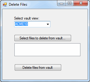

'  4. Ensure that the root folder of the vault contains an empty Folder1 and at
'     least one file.
'  5. Click Debug > Start Debugging or press F5.
' Postconditions:
'  1. The Delete Files dialog box displays.
'     a. Select a vault view.
'     b. Click Select files to delete from vault.
'     c. In the Select File dialog:
'        1. Click a file inside the vault.
'        2. Click Open.
'     d. Click Delete files from vault.
'  2. Click Delete in the Confirm Multiple File Delete dialog box.
'     a. If no errors occur, the selected file and Folder1 are moved
'        from the vault to the SOLIDWORKS PDM recycling bin. (To see the
'        SOLIDWORKS PDM recycling bin, right-click your vault, click
'        Properties, and click Deleted Items.)
'     b. If an error dialog box pops up, click OK to close it.
'  3. Close the Delete Files dialog box.
