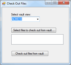

' Postconditions:
'  1. The Check Out Files dialog box displays.
'     a. Select a vault view.
'     b. Click Select files to check out from vault.
'     c. In the Select File dialog:
'        1. Click a couple of files inside the vault.
'        2. Click Open.
'     d. Click Check out files from vault.
'  2. Click Check Out in the Check Out dialog box.
'  3. Close the Check Out Files dialog box.
'  4. Observe that the selected files are checked out of the selected vault.

'Form1.Designer.vb
<Global.Microsoft.VisualBasic.CompilerServices.DesignerGenerated()> _
Partial Class Form1
    Inherits System.Windows.Forms.Form
    'Form overrides dispose to clean up the component list.
    <System.Diagnostics.DebuggerNonUserCode()> _
    Protected Overrides Sub Dispose(ByVal disposing As Boolean)
        Try
            If disposing AndAlso components IsNot Nothing Then
                components.Dispose()
            End If
        Finally
            MyBase.Dispose(disposing)
        End Try
    End Sub
    'Required by the Windows Form Designer
    Private components As System.ComponentModel.IContainer
    'NOTE: The following procedure is required by the Windows Form Designer
    'It can be modified using the Windows Form Designer.
    'Do not modify it using the code editor.
    <System.Diagnostics.DebuggerStepThrough()> _
    Private Sub InitializeComponent()
        Me.VaultsLabel = New System.Windows.Forms.Label()
        Me.VaultsComboBox = New System.Windows.Forms.ComboBox()
        Me.SelectFiles = New System.Windows.Forms.Button()
        Me.File1List = New System.Windows.Forms.ListBox()
        Me.BatchGet = New System.Windows.Forms.Button()
        Me.OpenFileDialog1 = New System.Windows.Forms.OpenFileDialog()
        Me.SuspendLayout()
        'VaultsLabel
        Me.VaultsLabel.AutoSize = True
        Me.VaultsLabel.Location = New System.Drawing.Point(36, 24)
        Me.VaultsLabel.Name = "VaultsLabel"
        Me.VaultsLabel.Size = New System.Drawing.Size(91, 13)
        Me.VaultsLabel.TabIndex = 0
        Me.VaultsLabel.Text = "Select vault view:"
        'VaultsComboBox
        Me.VaultsComboBox.FormattingEnabled = True
        Me.VaultsComboBox.Location = New System.Drawing.Point(39, 40)
        Me.VaultsComboBox.Name = "VaultsComboBox"
        Me.VaultsComboBox.Size = New System.Drawing.Size(121, 21)
        Me.VaultsComboBox.TabIndex = 1
        'SelectFiles
        Me.SelectFiles.Location = New System.Drawing.Point(39, 85)
        Me.SelectFiles.Name = "SelectFiles"
        Me.SelectFiles.Size = New System.Drawing.Size(191, 23)
        Me.SelectFiles.TabIndex = 2
        Me.SelectFiles.Text = "Select files to check out from vault..."
        Me.SelectFiles.UseVisualStyleBackColor = True
        'File1List
        Me.File1List.FormattingEnabled = True
        Me.File1List.HorizontalScrollbar = True
        Me.File1List.Location = New System.Drawing.Point(40, 114)
        Me.File1List.Name = "File1List"
        Me.File1List.SelectionMode = System.Windows.Forms.SelectionMode.MultiExtended
        Me.File1List.Size = New System.Drawing.Size(220, 43)
        Me.File1List.TabIndex = 4
        'BatchGet
        Me.BatchGet.Location = New System.Drawing.Point(40, 183)
        Me.BatchGet.Name = "BatchGet"
        Me.BatchGet.Size = New System.Drawing.Size(157, 23)
        Me.BatchGet.TabIndex = 6
        Me.BatchGet.Text = "Check out files from vault"
        Me.BatchGet.UseVisualStyleBackColor = True
        'OpenFileDialog1
        Me.OpenFileDialog1.FileName = "OpenFileDialog1"
        Me.OpenFileDialog1.Multiselect = True
        Me.OpenFileDialog1.Title = "Select File"
        'Form1
        Me.AutoScaleDimensions = New System.Drawing.SizeF(6.0!, 13.0!)
        Me.AutoScaleMode = System.Windows.Forms.AutoScaleMode.Font
        Me.ClientSize = New System.Drawing.Size(284, 235)
        Me.Controls.Add(Me.BatchGet)
        Me.Controls.Add(Me.File1List)
        Me.Controls.Add(Me.SelectFiles)
        Me.Controls.Add(Me.VaultsComboBox)
        Me.Controls.Add(Me.VaultsLabel)
        Me.Name = "Form1"
        Me.Text = "Check Out Files"
        Me.ResumeLayout(False)
        Me.PerformLayout()
    End Sub
    Friend WithEvents VaultsLabel As System.Windows.Forms.Label
    Friend WithEvents VaultsComboBox As System.Windows.Forms.ComboBox
    Friend WithEvents SelectFiles As System.Windows.Forms.Button
    Friend WithEvents File1List As System.Windows.Forms.ListBox
    Friend WithEvents BatchGet As System.Windows.Forms.Button
    Friend WithEvents OpenFileDialog1 As System.Windows.Forms.OpenFileDialog
End Class
