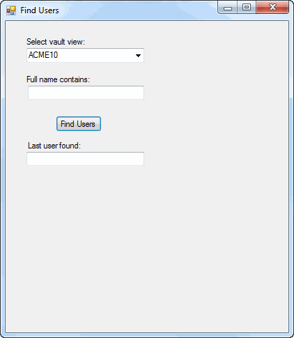

'  1. Displays the Find Users dialog box.
'     a. Select a vault view.
'     b. In Full name contains, type a substring of the full name of a
'        user that exists in the vault.
'     c. Click Find Users.
'        A message box confirms the substring typed in Postconditions
'        step 1b.
'     d. Click OK.
'        Displays a Search for users dialog.
'     e. Click Find.
'        Displays a Search for users dialog with results.
'     f. Click the first row.
'     g. Click Select.
'        * Displays a message box with the updated user information.
'        * The selected user's phone and website information are updated.
'     h. Click OK.
'  2. Updates the Find Users dialog box with the full name and picture, if
'     it exists, of the last user found whose full name contains the substring
'     typed in Postconditions step 1b.
'  3. Close the Find Users dialog box.

        Me.TextBox1.Location = New System.Drawing.Point(32, 93)
        Me.TextBox1.Name = "TextBox1"
        Me.TextBox1.Size = New System.Drawing.Size(167, 20)
        Me.TextBox1.TabIndex = 4
        'Label3
        Me.Label3.AutoSize = True
        Me.Label3.Location = New System.Drawing.Point(29, 172)
        Me.Label3.Name = "Label3"
        Me.Label3.Size = New System.Drawing.Size(83, 13)
        Me.Label3.TabIndex = 6
        Me.Label3.Text = "Last user found:"
        'TextBox2
        Me.TextBox2.Location = New System.Drawing.Point(30, 188)
        Me.TextBox2.Name = "TextBox2"
        Me.TextBox2.Size = New System.Drawing.Size(169, 20)
        Me.TextBox2.TabIndex = 7
        'Form1
        Me.AutoScaleDimensions = New System.Drawing.SizeF(6.0!, 13.0!)
        Me.AutoScaleMode = System.Windows.Forms.AutoScaleMode.Font
        Me.ClientSize = New System.Drawing.Size(406, 447)
        Me.Controls.Add(Me.TextBox2)
        Me.Controls.Add(Me.Label3)
        Me.Controls.Add(Me.TextBox1)
        Me.Controls.Add(Me.Label2)
        Me.Controls.Add(Me.Label1)
        Me.Controls.Add(Me.VaultsComboBox)
        Me.Controls.Add(Me.FindUsers)
        Me.Name = "Form1"
        Me.Text = "Find Users"
        Me.ResumeLayout(False)
        Me.PerformLayout()
