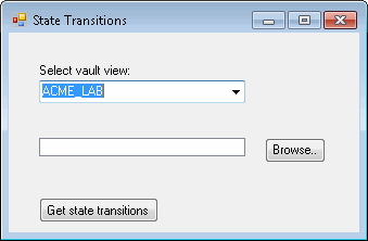

' 1. Displays the State Transitions dialog box.
' 2. Select a vault view.
' 3. Click Browse.
' 4. Displays the Select a file dialog box.
'    a. Select a file in the selected vault.
'    b. Click Open.
'    The selected file's path and file name appear
'    in the Select a file dialog box.
' 5. Click Get state transitions
' 6. Displays a message box showing the name of the selected
'    file and its current and next possible state transitions.
' 7. Click OK to close the message box.
' 8. Displays a message box showing whether the logged-in user must
'    add a comment when transitioning the selected file to one of its next
'    possible states.
' 9. Click OK to close the message box.
'10. Displays a message box with the archive server log.
'11. Click OK to close the message box.
'12. Close the State Transitions dialog box.

        Me.Controls.Add(Me.FileListBox)
        Me.Controls.Add(Me.VaultsComboBox)
        Me.Controls.Add(Me.VaultsLabel)
        Me.Name = "Form1"
        Me.Text = "Workflow State Transitions"
        Me.ResumeLayout(False)
        Me.PerformLayout()
    End Sub
    Friend WithEvents VaultsLabel As System.Windows.Forms.Label
    Friend WithEvents VaultsComboBox As System.Windows.Forms.ComboBox
    Friend WithEvents FileListBox As System.Windows.Forms.ListBox
    Friend WithEvents BrowseButton As System.Windows.Forms.Button
    Friend WithEvents OpenFileDialog1 As System.Windows.Forms.OpenFileDialog
    Friend WithEvents GetTransitionButton As System.Windows.Forms.Button
End Class
