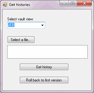

' Postconditions:
' 1. Displays the Get histories dialog box.
'    a. Select a vault view.
'    b. Click Select a file.
'    c. In the Select File dialog:
'       1. Select a checked-in vault file.
'       2. Click Open.
'       3. Updates all version comments for the selected file to
'          "New comment".
'    d. Click Get history.
'    e. Displays a message box for each history item.
'    f. Observe the updated version comments.
'    g. Click OK to close each message box.
'    h. Click Roll back to first version.
'       Rolls back the selected file to its first version.
'    i. Click Get history.
'       A message box displays one history item.
' 2. Close the Get histories dialog box.
