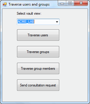

' Postconditions:
'  1. Displays a dialog.
'  2. Select a vault.
'  3. Click Traverse users.
'     Three message boxes report:
'     * users in the vault,
'     * state permissions for a user in the vault,
'       - and -
'     * transition permissions for a user in the vault.
'  4. Click OK to close each message box.
'  5. Click Traverse groups.
'     A message box reports the groups in the vault.
'  6. Click OK to close the message box.
'  7. Click Traverse group members.
'     A message box reports the users of each group in the vault.
'  8. Click OK to close the message box.
'  9. Click Send consultation request.
'     After several minutes, a SOLIDWORKS PDM Professional notification
'     appears only to logged-in users.
' 10. To open the message, click:
'     * the notification while it is displayed,
'     * the SOLIDWORKS PDM Professional tray icon,
'       - or -
'     * Tools > Inbox in the vault view.
' 11. Close the dialog.

        'VaultsLabel
        Me.VaultsLabel.AutoSize = True
        Me.VaultsLabel.Location = New System.Drawing.Point(46, 9)
        Me.VaultsLabel.Margin = New System.Windows.Forms.Padding(2, 0, 2, 0)
        Me.VaultsLabel.Name = "VaultsLabel"
        Me.VaultsLabel.Size = New System.Drawing.Size(91, 13)
        Me.VaultsLabel.TabIndex = 11
        Me.VaultsLabel.Text = "Select vault view:"
        'TraverseUsersButton
        Me.TraverseUsersButton.Location = New System.Drawing.Point(49, 69)
        Me.TraverseUsersButton.Margin = New System.Windows.Forms.Padding(2, 2, 2, 2)
        Me.TraverseUsersButton.Name = "TraverseUsersButton"
        Me.TraverseUsersButton.Size = New System.Drawing.Size(146, 41)
        Me.TraverseUsersButton.TabIndex = 15
        Me.TraverseUsersButton.Text = "Traverse users"
        Me.TraverseUsersButton.UseVisualStyleBackColor = True
        'TraverseGroupsButton
        Me.TraverseGroupsButton.Location = New System.Drawing.Point(49, 126)
        Me.TraverseGroupsButton.Margin = New System.Windows.Forms.Padding(2, 2, 2, 2)
        Me.TraverseGroupsButton.Name = "TraverseGroupsButton"
        Me.TraverseGroupsButton.Size = New System.Drawing.Size(146, 41)
        Me.TraverseGroupsButton.TabIndex = 16
        Me.TraverseGroupsButton.Text = "Traverse groups"
        Me.TraverseGroupsButton.UseVisualStyleBackColor = True
        'TraverseGroupMembersButton
        Me.TraverseGroupMembersButton.Location = New System.Drawing.Point(49, 183)
        Me.TraverseGroupMembersButton.Margin = New System.Windows.Forms.Padding(2, 2, 2, 2)
        Me.TraverseGroupMembersButton.Name = "TraverseGroupMembersButton"
        Me.TraverseGroupMembersButton.Size = New System.Drawing.Size(146, 41)
        Me.TraverseGroupMembersButton.TabIndex = 17
        Me.TraverseGroupMembersButton.Text = "Traverse group members"
        Me.TraverseGroupMembersButton.UseVisualStyleBackColor = True
        'SendConsultationRequestButton
        Me.SendConsultationRequestButton.Location = New System.Drawing.Point(49, 240)
        Me.SendConsultationRequestButton.Margin = New System.Windows.Forms.Padding(2, 2, 2, 2)
        Me.SendConsultationRequestButton.Name = "SendConsultationRequestButton"
        Me.SendConsultationRequestButton.Size = New System.Drawing.Size(146, 41)
        Me.SendConsultationRequestButton.TabIndex = 18
        Me.SendConsultationRequestButton.Text = "Send consultation request"
        Me.SendConsultationRequestButton.UseVisualStyleBackColor = True
        'UsersAndGroups
        Me.AutoScaleDimensions = New System.Drawing.SizeF(6.0!, 13.0!)
        Me.AutoScaleMode = System.Windows.Forms.AutoScaleMode.Font
        Me.ClientSize = New System.Drawing.Size(291, 317)
        Me.Controls.Add(Me.SendConsultationRequestButton)
        Me.Controls.Add(Me.TraverseGroupMembersButton)
        Me.Controls.Add(Me.TraverseGroupsButton)
        Me.Controls.Add(Me.TraverseUsersButton)
        Me.Controls.Add(Me.VaultsComboBox)
        Me.Controls.Add(Me.VaultsLabel)
        Me.Margin = New System.Windows.Forms.Padding(2, 2, 2, 2)
        Me.Name = "UsersAndGroups"
        Me.Text = "Traverse users and groups"
        Me.ResumeLayout(False)
        Me.PerformLayout()
    End Sub
   Friend WithEvents VaultsComboBox As System.Windows.Forms.ComboBox
   Friend WithEvents VaultsLabel As System.Windows.Forms.Label
   Friend WithEvents TraverseUsersButton As System.Windows.Forms.Button
   Friend WithEvents TraverseGroupsButton As System.Windows.Forms.Button
   Friend WithEvents TraverseGroupMembersButton As System.Windows.Forms.Button
   Friend WithEvents SendConsultationRequestButton As System.Windows.Forms.Button
End Class
