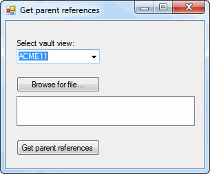

This example shows how to find the parent references of a file.

' Postconditions:
' 1. The Get parent references dialog displays.
' 2. Select a vault view.
' 3. Click Browse for file.
' 4. Locate and click one of the parts mentioned in Preconditions step 4.
' 5. Click Open.
' 6. Click Get parent references.
' 7. Displays the references of the selected part.
' 8. Click OK.
' 9. Close the Get parent references dialog.

    Private Sub InitializeComponent()
        Me.VaultsLabel = New System.Windows.Forms.Label()
        Me.VaultsComboBox = New System.Windows.Forms.ComboBox()
        Me.BrowseButton = New System.Windows.Forms.Button()
        Me.Listbox = New System.Windows.Forms.ListBox()
        Me.GetParentReferences = New System.Windows.Forms.Button()
        Me.OpenFileDialog = New System.Windows.Forms.OpenFileDialog()
        Me.SuspendLayout()
        'VaultsLabel
        Me.VaultsLabel.AutoSize = True
        Me.VaultsLabel.Location = New System.Drawing.Point(13, 26)
        Me.VaultsLabel.Name = "VaultsLabel"
        Me.VaultsLabel.Size = New System.Drawing.Size(91, 13)
        Me.VaultsLabel.TabIndex = 0
        Me.VaultsLabel.Text = "Select vault view:"
        'VaultsComboBox
        Me.VaultsComboBox.FormattingEnabled = True
        Me.VaultsComboBox.Location = New System.Drawing.Point(16, 42)
        Me.VaultsComboBox.Name = "VaultsComboBox"
        Me.VaultsComboBox.Size = New System.Drawing.Size(121, 21)
        Me.VaultsComboBox.TabIndex = 1
        'BrowseButton
        Me.BrowseButton.Location = New System.Drawing.Point(16, 81)
        Me.BrowseButton.Name = "BrowseButton"
        Me.BrowseButton.Size = New System.Drawing.Size(121, 23)
        Me.BrowseButton.TabIndex = 3
        Me.BrowseButton.Text = "Browse for file..."
        Me.BrowseButton.UseVisualStyleBackColor = True
        'Listbox
        Me.Listbox.FormattingEnabled = True
        Me.Listbox.HorizontalScrollbar = True
        Me.Listbox.Location = New System.Drawing.Point(16, 110)
        Me.Listbox.Name = "Listbox"
        Me.Listbox.Size = New System.Drawing.Size(259, 43)
        Me.Listbox.TabIndex = 4
        'GetParentReferences
        Me.GetParentReferences.Location = New System.Drawing.Point(16, 173)
        Me.GetParentReferences.Name = "GetParentReferences"
        Me.GetParentReferences.Size = New System.Drawing.Size(121, 23)
        Me.GetParentReferences.TabIndex = 5
        Me.GetParentReferences.Text = "Get parent references"
        Me.GetParentReferences.UseVisualStyleBackColor = True
        'Form1
        Me.AutoScaleDimensions = New System.Drawing.SizeF(6.0!, 13.0!)
        Me.AutoScaleMode = System.Windows.Forms.AutoScaleMode.Font
        Me.ClientSize = New System.Drawing.Size(289, 215)
        Me.Controls.Add(Me.GetParentReferences)
        Me.Controls.Add(Me.Listbox)
        Me.Controls.Add(Me.BrowseButton)
        Me.Controls.Add(Me.VaultsComboBox)
        Me.Controls.Add(Me.VaultsLabel)
        Me.Name = "Form1"
        Me.Text = "Get parent references"
        Me.ResumeLayout(False)
        Me.PerformLayout()
    End Sub
