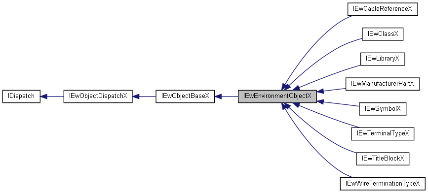

Inheritance diagram for IEwEnvironmentObjectX:
Inheritance graph
